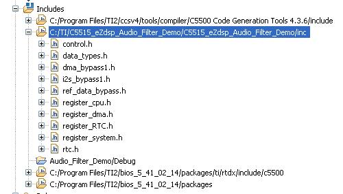

I would like to search *all* files and folders in my project (including "include" files) for certain source files. However, using control+H does not find files in my linked include files. Is there a way to include the linked includes in my search?
Hi Mike,
If should find any linked header files. What it won't find are header files specified in include search paths. Basically if it shows up in your C/C++ Projects view, and is not in the "Includes" folder, it should find it.

Yes, I saw TommyG's thread.
So, it sounds like the answer to your question is, NO. There is no way to search for a file that resides in the "includes" directories in my project file? This seems like a major oversight or shortcoming of CCS4/Eclipse.

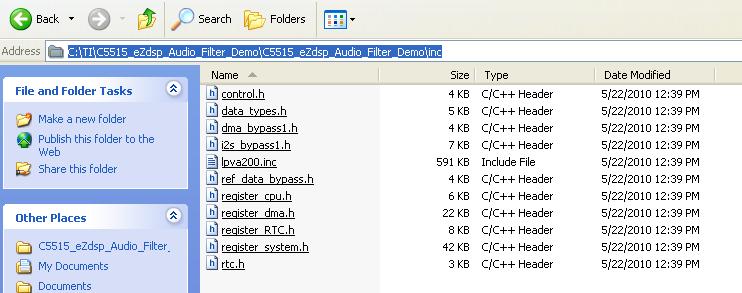

For example, my project (AudioFilterDemo) includes 3 .asm files. They all include lpva200.inc. I searched and searched but could not find lpva200.inc to see what's inside of it. I finally used a Windows search to find that it is located in the orginal download/unzip location of the demo files (C:\TI\C5515_eZdsp_Audio_Filter_Demo\C5515_eZdsp_Audio_Filter_Demo\inc). HOWEVER, this file (lpva200.inc) DOES NOT SHOW UP IN CCS4, even if I expand the included file list in the "includes" file. Here is a snapshot of the CCS4 project includes, and a windows explorer listing of these files. Note lpva200.inc in the bottom image, but not in the top image.
