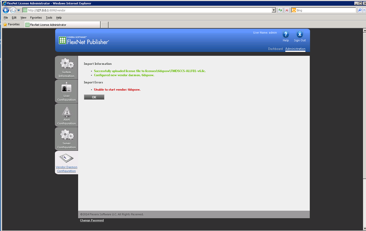

Unable to start vendor: tidspssw
I am unable to start the Flexlm Service 1 service.

    - I got to step 8
    8. In the main administration view click on Vendor Daemon Configuration and click on the Import License icon. Browse to where the .lic file is located and click on Import license. A message will be displayed saying the license was successfully imported. Click OK.
    - I browsed to my license file and clicked on the import license file button. Here is what I see.
    - As you can see, I already fail at step 8!
    Now that I am going through the procedure again, I do recall seeing this message the first time around. I should not have proceeded past step 8, but rather reached out.

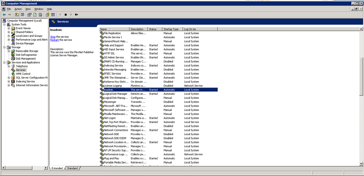

    - I verified that the lmadmin service is running. I even tried deleting the license stuff (after clicking on the ok button), making sure lmadmin was running, and importing the license file again (checking the box to overwrite). I still get the same message.
    - Here is a screenshot showing the Computer Management Services tab. Lmadmin started, but "Flexlm Service 1" did not.
    4. Log file
    Interesting! I tried starting "Flexlm Service 1" from the Services applet anyways. I also tried previously from the GUI, however that did not generate a log file. My attempt from the Services applet yielded a log entry!

    13:02:39 (lmgrd) Detecting other license server manager (lmgrd) processes...
    13:02:39 (lmgrd) Done rereading
    13:02:39 (lmgrd) FlexNet Licensing (v11.12.1.1 build 150159 i86_n3) started on jmr-stamp01 (IBM PC) (3/29/2016)
    13:02:39 (lmgrd) Copyright (c) 1988-2014 Flexera Software LLC. All Rights Reserved.
    13:02:39 (lmgrd) World Wide Web:  http://www.flexerasoftware.com
    13:02:39 (lmgrd) License file(s): C:\flexlm\license.dat
    13:02:39 (lmgrd) lmgrd tcp-port 27000
    13:02:39 (lmgrd) (@lmgrd-SLOG@) ===============================================
    13:02:39 (lmgrd) (@lmgrd-SLOG@) === LMGRD ===
    13:02:39 (lmgrd) (@lmgrd-SLOG@) Start-Date: Tue Mar 29 2016 13:02:39 Pacific Daylight Time
    13:02:39 (lmgrd) (@lmgrd-SLOG@) PID: 1344
    13:02:39 (lmgrd) (@lmgrd-SLOG@) LMGRD Version: v11.12.1.1 build 150159 i86_n3 ( build 150159 (ipv6))
    13:02:39 (lmgrd) (@lmgrd-SLOG@) === Network Info ===
    13:02:39 (lmgrd) (@lmgrd-SLOG@) Socket interface: IPV4
    13:02:39 (lmgrd) (@lmgrd-SLOG@) Listening port: 27000
    13:02:39 (lmgrd) (@lmgrd-SLOG@) === Startup Info ===
    13:02:39 (lmgrd) (@lmgrd-SLOG@) Is LS run as a service: Yes
    13:02:39 (lmgrd) (@lmgrd-SLOG@) Server Configuration: Single Server
    13:02:39 (lmgrd) (@lmgrd-SLOG@) Command-line options used at LS startup: -c C:\Program Files\FlexNet Publisher License Server Manager\TMDSCCS-ALLF01-v6.lic -l :\Program Files\FlexNet Publisher License Server Manager\Ti-Licensing.log -z -s
    13:02:39 (lmgrd) (@lmgrd-SLOG@) License file(s) used:  C:\flexlm\license.dat
    13:02:39 (lmgrd) Starting vendor daemons ...
    13:02:39 (lmgrd) License server manager (lmgrd) startup failed:
    13:02:39 (lmgrd) CreateProcess error code: 0xc1   File= tidspssw.exe

    Since your last (more?) updates, I have made major progress. Please see my updated earlier response. You wrote, while I was updating a previous response.
    Texas Instrument Wiki Documentation Installation Failures:
    1. Create C:\flexlm.
    2. Users must copy and then rename the license file, TMDSCCS-ALLF01-v6.lic, in my case, to "license.dat" placing that in the C:\flexlm directory. That means that after this step "C:\flexlm\license.dat" exists.
    3. When doing the wiki steps, do NOT manually create or edit any logs, even if they do not exist. Starting the service from the Computer Management Services page will create the log. The log will not generate if a user manually creates the file or adds content not placed automatically by the service.
    4. Follow Windows Wiki steps 1 through 10.
    5. After step 8, a user might have to restart the server in order to see "Flexera Service 1" start without seeing lmgrd already running issue.
    Once done, please feel free to update the Wiki documentation.
    Even though I am not at the end of the road, Texas Instruments is purely at fault, as there are missing steps, which I am now discovering. The software is fine, but instructions are not. Yes, I realize that the instructions are obvious for 99.99% of people to follow and creating C:\flexlm and doing the rename, but to idiots, such as myself, following the Wiki instructions TO THE LETTER, the procedure is not obvious and will not work. Nowhere does the Wiki instructions say to rename files, create folders, and jump through hoops. I am discovering these steps manually.
    Anyways, pushing forward. Hopefully I am almost there.
    What do you think about the next issue and why tidspssw.exe does not start?

  • Progress! With much thanks to my two colleagues, myself and I. Texas Instruments support personnel continue to show that they are ignorant and clueless to their own products. The Texas Instruments CEO should be embarrassed, but is probably too rich to be embarrassed. Anyways, I hope that my trials help someone. I almost done.
    NOTES:
    1. I was right in my earlier questioning of Windows Server 2003. The currently shipping version of tidspssw.zip is for Windows Server 2012 and maybe Windows Server 2008, but definitely not Windows Server 2003. There is an older version, which is compliant. There is another article, where the engineer stated the issue and gave a link to the correct download. Thankfully, I was able to find the article. I finally put in the correct search terms into Google.
    e2e.ti.com/.../424872
    2. I set the environment variable as follows, just it did not work. I am not sure how the other person in the ticket listed above got lmgrd to use the specified location. My renaming and placing in the created C:\flexlm did the trick. Those are the exact same files.
     LM_LICENSE_FILE=E:\Licensing\flexlm;
    3. I restarted the server, required, and everything started. The only issue that I see from the log is "Unable to initialize access to trusted storage," whatever that means. Can storage be the license file?
    9:26:06 (lmgrd) ----------------------------------------------- 9:26:06 (lmgrd) 9:26:06 (lmgrd) 9:26:06 (lmgrd) Server's System Date and Time: Wed Mar 30 2016 09:26:06 Pacific Daylight Time 9:26:06 (lmgrd) pid 1360 9:26:06 (lmgrd) SLOG: Summary LOG statistics is enabled. 9:26:06 (lmgrd) Detecting other license server manager (lmgrd) processes... 9:26:06 (lmgrd) Done rereading 9:26:06 (lmgrd) FlexNet Licensing (v11.12.1.1 build 150159 i86_n3) started on jmr-stamp01 (IBM PC) (3/30/2016) 9:26:06 (lmgrd) Copyright (c) 1988-2014 Flexera Software LLC. All Rights Reserved. 9:26:06 (lmgrd) World Wide Web: http://www.flexerasoftware.com 9:26:06 (lmgrd) License file(s): C:\flexlm\license.dat 9:26:06 (lmgrd) lmgrd tcp-port 27000 9:26:06 (lmgrd) (@lmgrd-SLOG@) =============================================== 9:26:06 (lmgrd) (@lmgrd-SLOG@) === LMGRD === 9:26:06 (lmgrd) (@lmgrd-SLOG@) Start-Date: Wed Mar 30 2016 09:26:06 Pacific Daylight Time 9:26:06 (lmgrd) (@lmgrd-SLOG@) PID: 1360 9:26:06 (lmgrd) (@lmgrd-SLOG@) LMGRD Version: v11.12.1.1 build 150159 i86_n3 ( build 150159 (ipv6)) 9:26:06 (lmgrd) (@lmgrd-SLOG@) 9:26:06 (lmgrd) (@lmgrd-SLOG@) === Network Info === 9:26:06 (lmgrd) (@lmgrd-SLOG@) Socket interface: IPV4 9:26:06 (lmgrd) (@lmgrd-SLOG@) Listening port: 27000 9:26:06 (lmgrd) (@lmgrd-SLOG@) 9:26:06 (lmgrd) (@lmgrd-SLOG@) === Startup Info === 9:26:06 (lmgrd) (@lmgrd-SLOG@) Is LS run as a service: Yes 9:26:06 (lmgrd) (@lmgrd-SLOG@) Server Configuration: Single Server 9:26:06 (lmgrd) (@lmgrd-SLOG@) Command-line options used at LS startup: -c C:\Program Files\FlexNet Publisher License Server Manager\TMDSCCS-ALLF01-v6.lic -l :\Program Files\FlexNet Publisher License Server Manager\Ti-Licensing.log -z -s 9:26:06 (lmgrd) (@lmgrd-SLOG@) License file(s) used: C:\flexlm\license.dat 9:26:06 (lmgrd) (@lmgrd-SLOG@) =============================================== 9:26:06 (lmgrd) Starting vendor daemons ... 9:26:06 (lmgrd) Started tidspssw (pid 1708) 9:26:08 (tidspssw) Unable to initialize access to trusted storage: 1 9:26:09 (tidspssw) FLEXnet Licensing version v11.4.100.0 build 50818 i86_n3 9:26:09 (tidspssw) lmgrd version 11.12, tidspssw version 11.4 9:26:09 (tidspssw) Server started on jmr-stamp01 for: CCS_CONNECTION_ALL 9:26:09 (tidspssw) CCS_LINKER_FULL CCS_ISA_ALL CCS_DEBUGGER 9:26:09 (tidspssw) EXTERNAL FILTERS are OFF 9:26:10 (lmgrd) tidspssw using TCP-port 1061 9:30:16 (tidspssw) TCP_NODELAY NOT enabled
    4. With a freshly booted server, I went to CCS and saw after a time of waiting this dialog. CCS can now see the license server manager and vendor daemon processes, but cannot communicate with the license service. I would say a port issue, however CCS would not know that the services exist, if it could not communicate on port 8090. Maybe port 27000 needs opening, if I even have a firewall enabled. The error code is 16287.
    As I said, progress. Also, the Ti Documentation installation Wiki is clearly lacking. Training of Ti staff is also lacking.
  • Okay, final entry. I should be prayed to, much more so than Jobs, Gates, or anyone, as the trio of super geniuses: me, myself, and I, finally resolved the remaining issue. Since talk is cheap, here is the proof.
    The last problem and missing step in the instructions is the port to use in CCS (Code Composer Studio). The port is not 8090, as I had thought, but rather 27000. It might be any port in the range specified somewhere in my reading. Going to the log will state the actual port. I guess 8090 is for the admin in the browser, not licensing. Yeah, I know, obvious to 8 billion people waking up at 2:00 AM, but let us say 8 billion minus one, me. That was so not obvious and a query to Ti non-support could not mention that. Okay, 8 billion less everyone at Ti.
    The trusted server storage error is expected and not important. TI support (Billy) had at least one neuron in his head and could answer that, although I saw the same thing shortly before that in an AutoCAD article dealing with Flexlm. Here is the quote: "That trusted storage is a meaningless line entry. This is expected and has 0 impact. It just a different method of access."
    If anyone read this far, I would appreciate massive amounts of up votes on SO posts as compensation.
