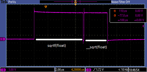

  • This is my test result.
    First transition is with 10 times sqrtf(float) instruction and second transition is 10 times __sqrtf(float) instruction.
    As you can see instruction cycles deacreases %50.
    But each instruction of __sqrtf(float) is apprx. 400ns. I think it is big time. Am I right in this case ?
