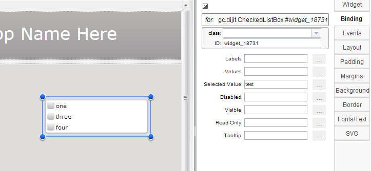

  • To run outside of CCS you need a GC Runtime, your can downloaded from page below.
    http://processors.wiki.ti.com/index.php/Category:GUI_Composer
    It also has some information on exporting an app.
    Red X on the widget usually means that symbol that you entered for the binding is not valid OR you have not specified the .out file where symbols need to be obtained. Also, these variables need to be global.
    Add "test" to "Selected Value" binding.  See picture
