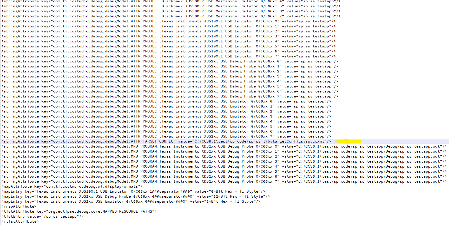

I have a workspace which contain several CCS projects that working together to produce outcome. I exported this workspace by select all of its folders(CCS projects), so it becomes a .zip file. My idea is keep the old workspace as it is. Build a new workspace then import this .zip file. When I build this new workspace, it complain missing one of the CCS project's location file which could not be found. Because that folder it's originally from Git when I build the old workspace. I copy paste that folder from Old workspace to this new workspace. It builds successfully, but when it runs, the ccxml file which is for target still point toward old workspace. I don't know where and how to fix this issue. I went to each of the folder make sure all of the paths either link to the TI folder or this new workspace folder. I check the gel file make sure they link the gel file from TI folder as well. I am running out of the ideas.
What exactly is pointing to the old workspace? The ccxml file itself or paths referenced in the ccxml file (like the GEL file)? A screenshot of the issue would be helpful.

I update the screen shot where I think I discover the issue. It's part of my "testapp"'s launch file. Basically, I import my old project.zip file which called "test". My new workspace is not this name, I run the application from "testapp", trace on the launch process, somehow, the target still from old project directory.
