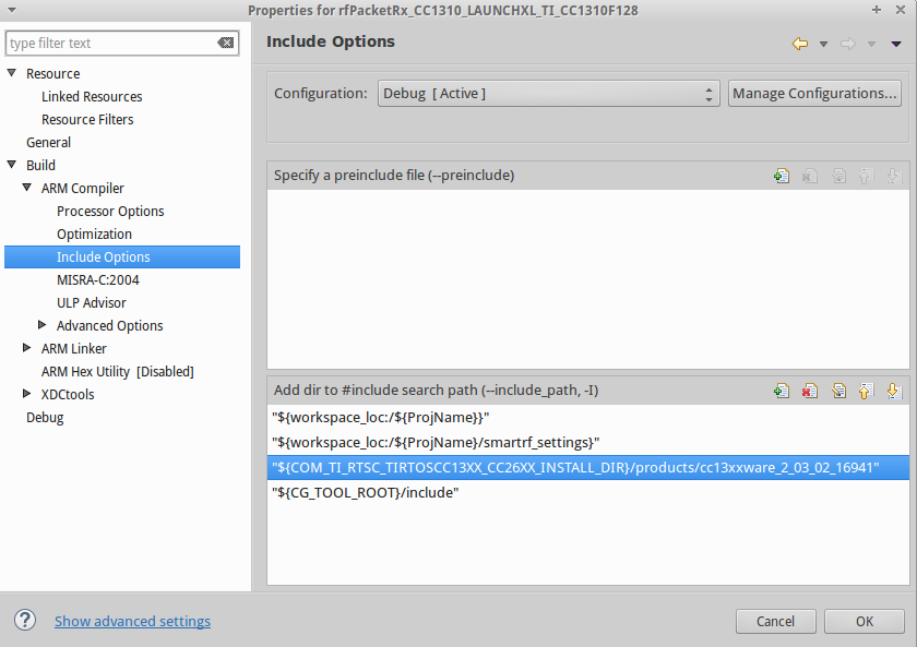

How is it possible to link a resource to the current TI-RTOS installation folder? I want to link to a board file folder or include board files into a project without copying everything.
I noticed that the TI-RTOS plugin provides a special variable "COM_TI_RTSC_TIRTOSCC13XX_CC26XX_INSTALL_DIR", but it is only available in the build configuration and can not be used as path variable in the project explorer.

    who sets those COM_TI_RTSC_TIRTOSCC13XX_CC26XX__XXX variables in your case? The TIRTOS eclipse plugin? Do they change when you switch the TI-RTOS version for an existing project? Are they documented somewhere?
    I use CCS 6.1.2 + TIRTOS 2.16.1 (separate installation) and they are not listed in my projects. Neither in the current TIRTOS engineering release. But the variable COM_TI_RTSC_TIRTOSCC13XX_CC26XX_INSTALL_DIR is "magically" there during the build process, although not present in "Path Variables". Also all other TI-RTOS sub-product folders are "magically" set as include paths, but not the one for CC13XXWARE.
    I ran a quick "grep" on my TI-RTOS installation and found many references for COM_TI_RTSC_TIRTOSCC13XX_CC26XX_INSTALL_DIR all over, but none for COM_TI_RTSC_TIRTOSCC13XX_CC26XX__ (notice the double underscore).
    To sum it up, two problems here:
    • COM_TI_RTSC_TIRTOSCC13XX_CC26XX_INSTALL_DIR is not set as path variable, but only available during build. I can not link resources based upon that variable.
    • The include and linker search path for CC13XXWARE is hardcoded based on the invisible COM_TI_RTSC_TIRTOSCC13XX_CC26XX_INSTALL_DIR variable. That makes switching between TI-RTOS versions in a project really painful.

    I see those variables in CCS 6.1.3 but not in CCS 6.1.2. And yes they do change when I switch the TI-RTOS version for a project. Can you try installing 6.1.3 to see if they are visible to you?

    For the first problem I think you should be able to manually create that path variable if it is not picked up by default. But based on what I see,CCS 6.1.3 solves these issues. If you still find that it not working as expected with CCS 6.1.3, please start a new post in the TI-RTOS forum as the experts there may be able to provide additional comments.
