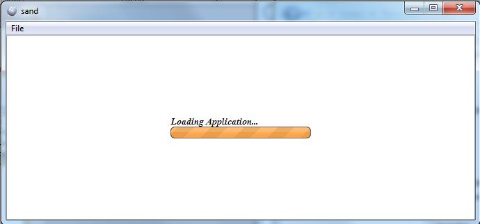

  • Hi Martin,
    After trying what you wrote it still doesn´t work. I followed all your steps, download the GC runtime, copy my programm into guicomposer\webapps folder and once i have exported it, try to run it. It looks like something is going to happen but then it just appears this screen to me, loading permanently.
    Hope you can help me,

  • Hi Alejandro,
    Attached file is what we are looking for. I dropped your app into GC Runtime installation that I posted above. I have used 432 LaunchPad ( i believe this is what you are using) and during debug access initialization I got errors. The appInitScript.js that is part of your app does not seem to have quite the correct content (at least not for MSP432). Do you recall if you manually modified or copied this file? If not, then would be able to let us know which version of CCS you used to create your app? In some early releases that template file did not always have correct content. In any case, I made tweaks necessary to make it work with 432 (see below for lines that I commented out). After this GC app performed the initialization correctly and the app started to work. Meaning that GUI appeared with no errors and I was able to turn the dial widget and number spinner box was updated. I see that you bound both to "z" variable, thus I am concluding that writing and reading actually worked.
    If after modifying the script, things still get stuck in Loading then we may need to collect some additional logs. GC Runtime is starting a local webserver and the application window that appears (where you see the Loading message) is just a wrapped web browser. It is possible that your issue has to do with problem establishing a communication channel between server and client. Is it possible that some firewall setting could be affecting communication?

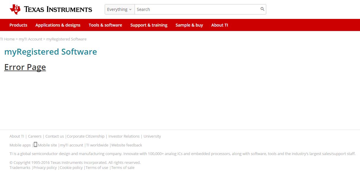

  • Hello Martin,
    I get an error after clicking the link you have writen.
    Alejandro
  • ok no problem , downloading!
    don´t know what happened
    Alejandro
  • Could you try again? Please refresh (or reload) the page on your browser. I noticed that my original link did not quite have the right content and I edited the post to have correct link.
