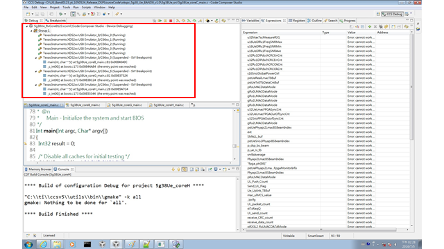

Debug Server Scripting (DSS) of the JavaScript code can not be simultaneously multi-core run
Other Parts Discussed in Thread: TCI6638K2K, CCSTUDIO
I want to use TI provided Debug Server Scripting (DSS) function, and through write JavaScript code to the CCS 5 program download to the DSP (TCI6638K2K)
The following is the JavaScript code content

But  "Run program" phase, can not run eight core simultaneously , only five core can run, as shown below.
    A few observations:
    I am assuming that you are running your script from the CCS Scripting Console after you have started a debug session. Is that correct?
    I do not see an actual (simultaneous) run command. After program load, all I see the script creating the array of debug sessions and nothing more.
    From your screenshot I can see that the first 5 cores are running while the last three are halted at main. Given that, and the fact that you do not have a run command in the script, it looks like the first 5 cores are unable to auto-run to main while the last 3 is successful (the debugger will try to auto-run to main on program load). Is this indeed the case and that the issue is really that the first 5 cores are unable to auto-run to main?
    Also note that CCSv5 is an older version that has been deprecated in support. If possible, I recommend updating your CCS version to something more current.

    Thanks for getting back to me.
    i'm sorry, that JavaScript code is not correct version.
    i use "debugServer.simultaneous.run(dsArray);" run command to run multi-core, but only 5 cores can auto-run, last 3 cores can't auto-run.

    i try another way, i use "debugSession0.target.run();" run command, one by one sequential run multi-core, but only first core can auto-run.

  • As I mentioned earlier, it seems like the programs for the first 5 cores are unable to reach main. What I would like to know is if you manually just load each program to each core, are they all able to reach 'main' and stay halted there? Do all the programs have a 'main'?

  • all the programs have a “main” and when I finish download program, all program able to reach 'main' and stay halted there
    I have confirm correct load program to DSP, and after eight core loading, and just try to run core 4, 5, 6, 7, but there will not be run, just stay in the eight core loaded state.
