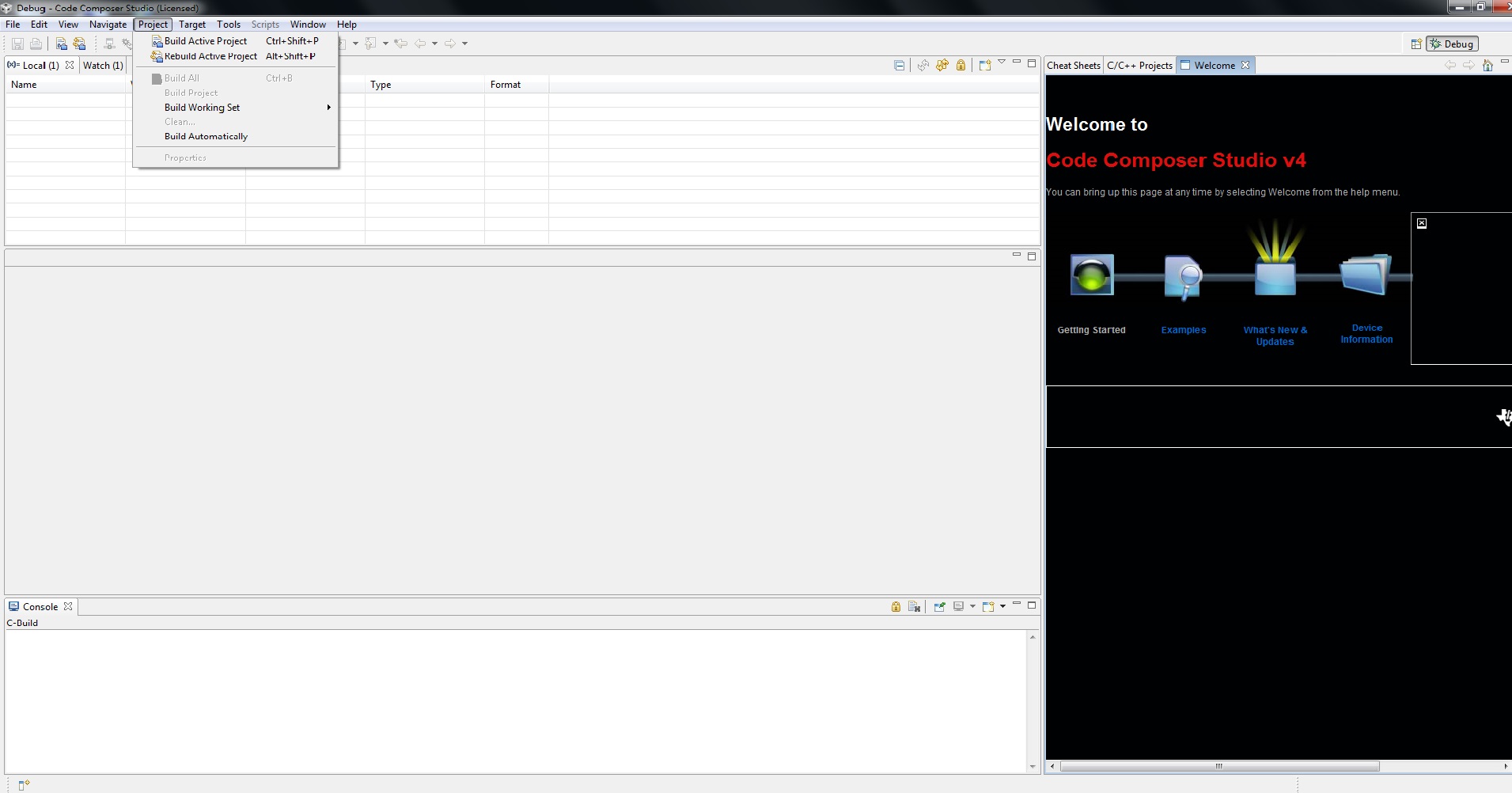

Actually I can't add the the workspace by clicking “Project->Import Existing CCS/CCE Eclipse Project. As I can't see "Import Existing CCS/CCE Eclipse Project" option in Project Tab.

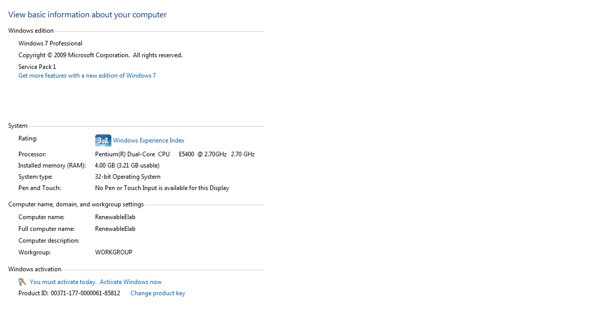

    To better assist you, please provide more details. At minimum, we need to know what exact CCS version you are using and what host OS. Also, a screenshot of your CCS environment would be very helpful.

                       Thank you for your kind reply, I m using CCS version 4.1.0.0.2005 on windows operating system!!!
    Actually I want to Flash F28035 Control Card to work with GUI of TMDSDCDCLEDKIT for which I need to import Existing CCS/CCE Eclipse Project but I cant see that option.
    Screen shots of OS information and CCS are attached
  • I see that you are in the Debug perspective. Please switch to the C/C++ and try again.
