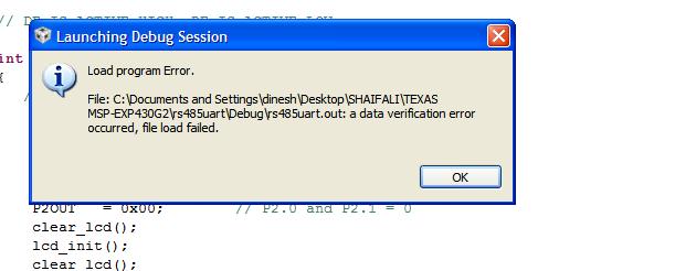

hello,
I am using MSP430G2553 launch pad, windows xp and trying to debug the program but each time the following error comes.
this is the setting in the run ->debug configuration. I tried manually to enter the path, created new project but same problem occuring. Please help me to find the issue.

Did you check your linker command file, debugger memory map and memory accessibility as suggested in the above wiki?
The address 0xFFE4 is an interrupt vector, and it should be able to be programmed.harish yadav said:MSP430: File Loader: Verification failed : Values at address 0xFFE4 do not match Please verify target memory and memory map.
Can you enable the CCS Debug Server Logging and attach the log file from when CCS reports the data verification failure.
Also which version of CCS are you using?
In the past there have been other case where interrupt vectors failed to be programmed correctly, but the root cause wasn't clear (e.g. HELP!!! MSP430: File Loader: Data verification failed...)
