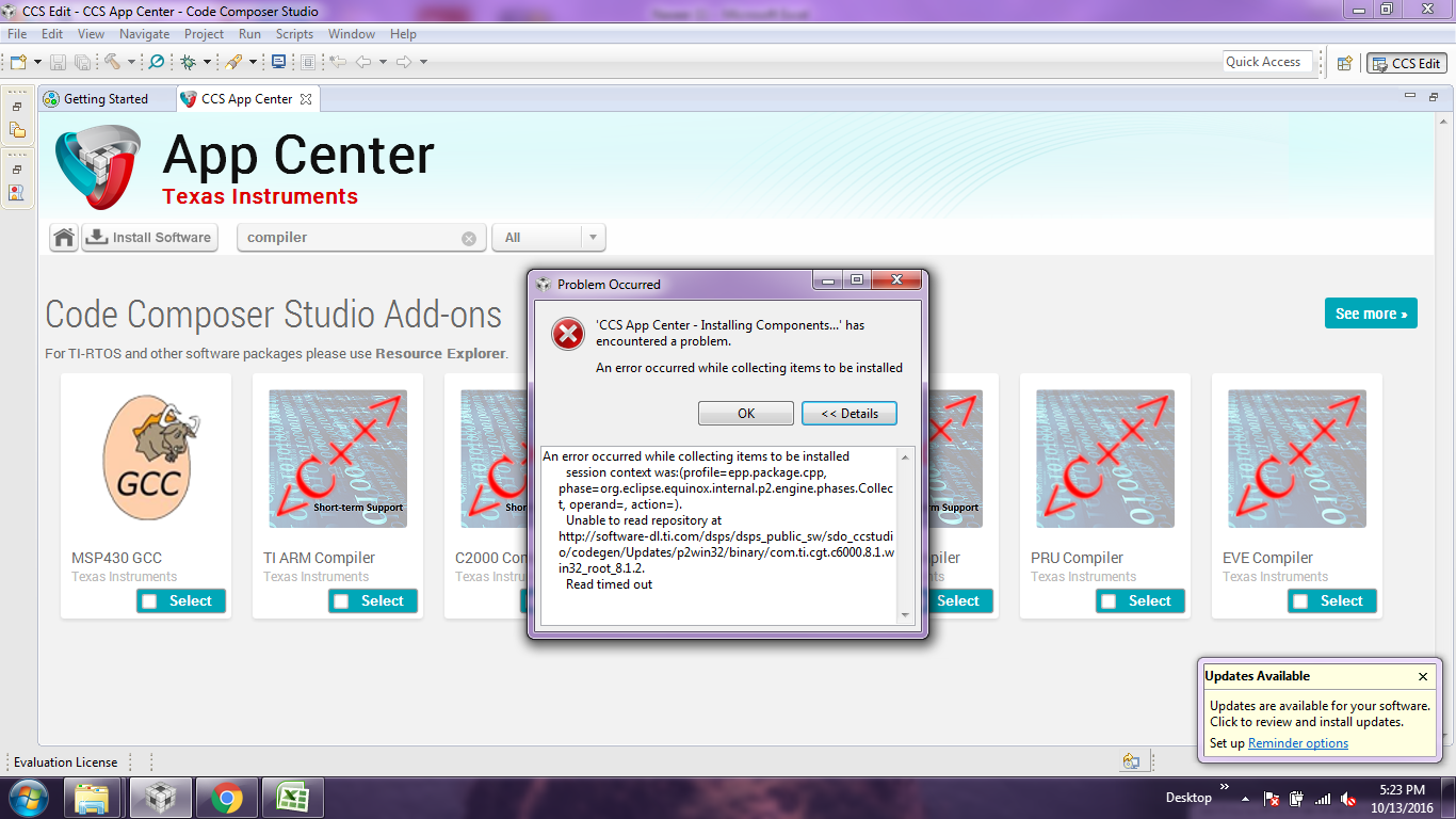

Dear sir,
Am using CCSv6.2,and when i need to install C6000 compiler form CCS App center i got the error................see the attachment ..........
Am using WINDOWS 7 n CCS6.2,i turned off WINDOWS FIREWALL n ANTIVIRUS while installing CCS,and i got the installation finish successfully.........
MOHAMMAD NASEER M N said:Am using CCSv6.2,and when i need to install C6000 compiler form CCS App center i got the error.
Is it only this compiler update that produces the error or all updates? If it is all updates, you may want to check your proxy settings:
http://processors.wiki.ti.com/index.php/Updating_CCSv6#Proxy_Configuration
Also try the suggestions in item 5 of this section: http://processors.wiki.ti.com/index.php/Troubleshooting_CCSv6#Update_features

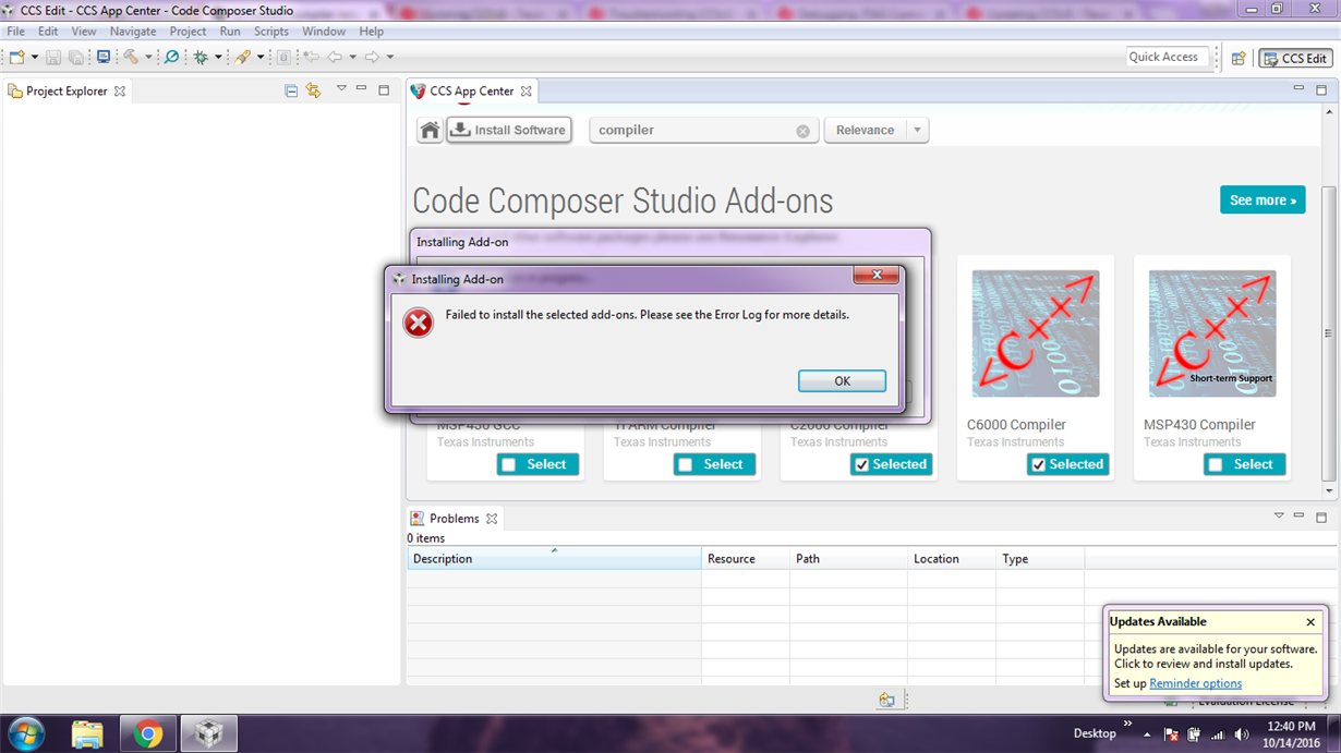

Hi AartiG,
YES,for all it is showing error for all install.............
My system is not with proxy settings,it is DHCP........
the screen shot now for C6000 compiler,because i deleted the cache folder from ccs6\p2\..
thank you.
Please take a look at the Error Log and see if it provides additional clues as to why the update failed. It is the .log file in the .metadata directory within your workspace.
If you attach it here we could also check to see if it provides any details.
