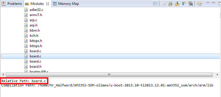

    When browsing the loaded symbols via the modules view, I can see that there are three board.c references, of which the path information is relative with just the file name:
    Hence I believe that it will look for a source file call board.c relative to the loaded symbol file, which is why the debugger (when halted) pull out the board.c in the same directory as the symbol file (elf image). The debugger will always try to use relative path information first (relative to the path of the loaded symbol file) when trying to open a source file in the editor when halted.
    As for why the breakpoint set on board_init_f is referencing the correct board.c location, when looking in the modules view for that function:
    It has the correct file path for the board.c for the debug info for the function.
    I'll need to confirm with the engineers here if what I described is accurate (and more importantly if it is a bug).
