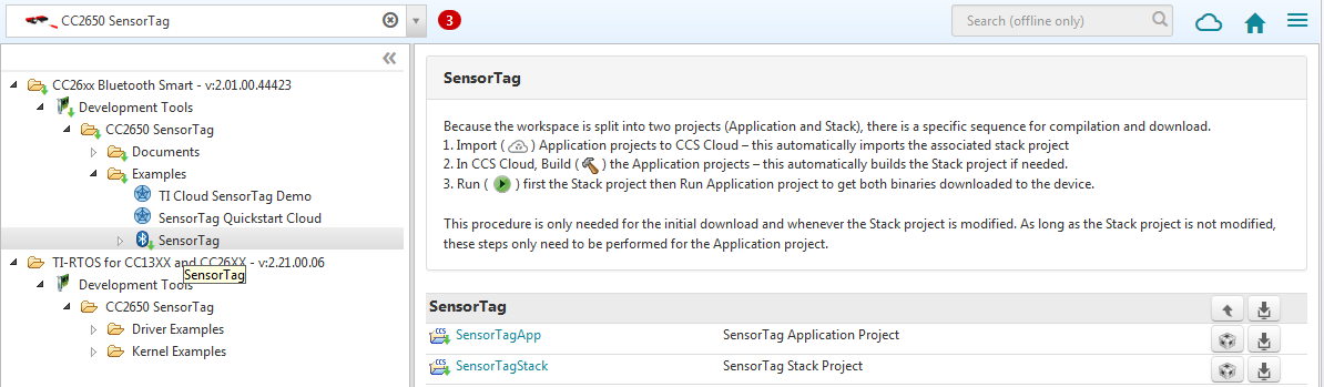

  • Rachel,
    Rachel Vrabec said:
    1. where do I find the right default firmware to update and/or restore my sensor to factory settings? There are several projects I can download from resource explorer that are labeled cc2650...
    From inside the Resource Explorer you can search for the specific board (Sensortag):
    Then you can look for the Sensortag demo application:

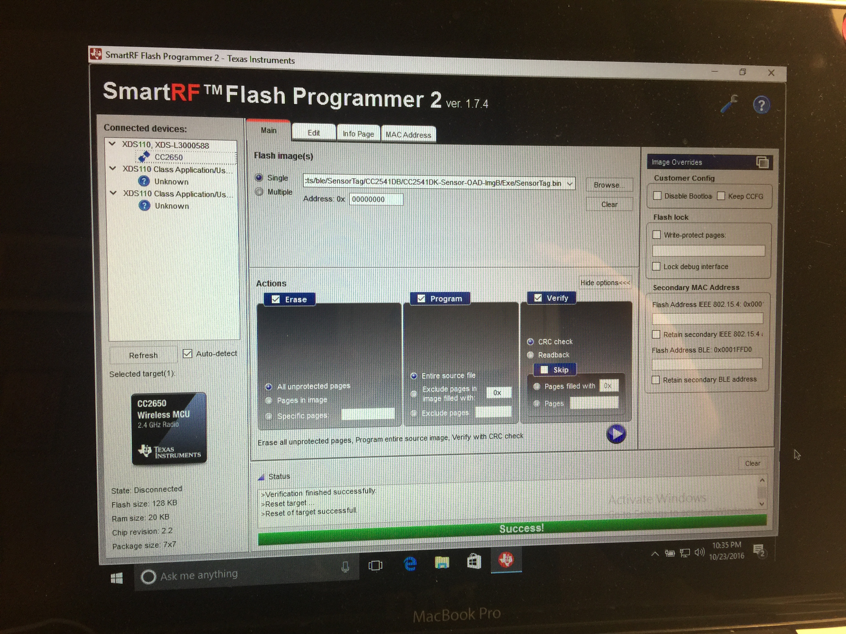

  • Thank you Rafael,
    So I will work exclusively from those files.
    For the target error,  after trying it a few different ways I've been able to load the .bin file from image B onto my sensor using flash 2, virtual box, a usb, and debugger. The load ran successfully, (see image below), but now my sensor is frozen and the red light is stuck on unless I remove the battery. I try to reset by pressing and holding both buttons for 6 seconds, but it doesn't reset.  Do you know why this might be?
    Also for my other approach, when I add the sensortag .bin file to my TI app via itunes, and try to load over the air using the firmware update options on the app, I get the error similar to this thread - "did not disconnect properly"...   https://e2e.ti.com/support/wireless_connectivity/bluetooth_low_energy/f/538/t/325044
    Thanks so much for your help!
  • I should also mention that when I try to restore the tag by flashing the example image back on to the sensor tag, it fails. Any recommendations for getting my sensortag back working would be much appreciated
    I did not have any issues running this version of the BLE Stack. However, I used CCS instead of the SmartRF programmer - I first flashed the SensorTagStack project by clicking on the green bug button, then I closed the debug session and flashed the SensorTag project using the same button. I also closely followed the instructions to connect the DevPack to the Sensortag and power it.
