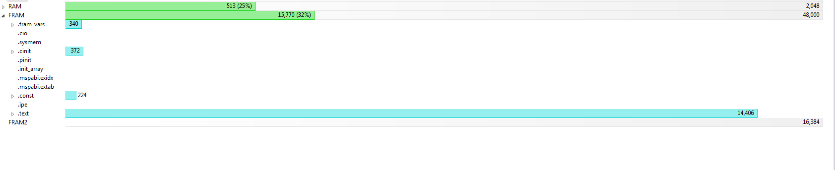

I'm looking at the information in the Memory Allocation View:

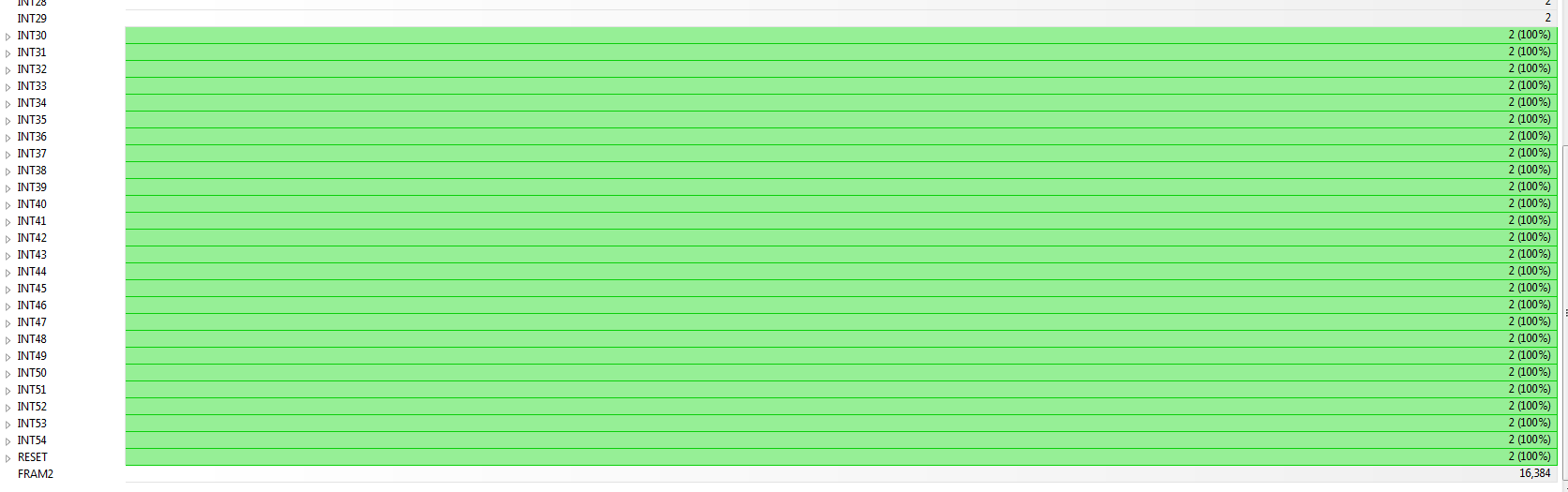

and I don't understand why the sections in FRAM don't add up to 15,770
I've attempted to add the peripheral sections, UNMI and SYSNMI that range from ffcc to fffe. I also added the following table:
LINKER GENERATED COPY TABLES
__TI_cinit_table @ 00004964 records: 2, size/record: 8, table size: 16
.data: load addr=00004800, load size=0000014f bytes, run addr=00001c00, run size=00000149 bytes, compression=copy
.bss: load addr=0000495e, load size=00000006 bytes, run addr=00001d4a, run size=00000018 bytes, compression=zero_init
This gives me the following:
I am still missing 35 bytes! What am I missing?

  • Thanks Chester,  I'm happy to know that option exists, but even when showing All Ranges the total FRAM used does still not add up. In fact, showing All Ranges verifies that I had correctly allocated 52 bytes for the IVT. I was calculating things incorrectly, but now I'm just using the numbers in the Memory Allocation view and this is what I get:
    this gives me 15,342 bytes plus 52 bytes of IVT:
    totaling 15,394 bytes...so I'm still missing 376 bytes. Any ideas where I can find these missing bytes?
    Looking again the problem wasn't the Memory Allocation view not showing all regions, but that the breakdown of the allocations in the FRAM region didn't add up.
    The Memory Allocation view is derived from the contents of the *linkInfo.xml file produced the linker. The Memory Allocation view reports the allocated size of the FRAM region is 15770 bytes which matches the summary from the linker map file:
             name            origin    length      used     unused   attr    fill
      FRAM                  00004400   0000bb80  00003d9a  00007de6  RWIX
    Can you post the *linkInfo.xml file produced the linker?
    I attached the linkInfo.xml
    Looking at the linkInfo.xml file shows the overall FRAM area as:

    i.e. the FRAM area has two allocated spaces of size 0x154 and 0x3c46 = 15770 bytes = the total usage of the FRAM region reported in the CCS Memory Allocation view.
    The allocated_space of start address 0x4400 and size 0x154 is occupied by the .fram_vars section reported in the linker map file:
    .fram_vars
    *          0    00004400    00000154
                      00004400    00000150     main.obj (.fram_vars:uninit) [fill = 0]
                      00004550    00000004     main.obj (.fram_vars:init)
    The allocated_space of start address 0x4800 and size 0x3c46 is occupied by the following sections in the linker map file:
    .cinit     0    00004800    00000174
    .const     0    00004974    000000e0  /* .const allocated immediately after end of .cinit */
                                          /* gap of 0x1AC bytes between end of .cinit section and start of .text section */
    .text      0    00004c00    00003846  /* 0x3C46 bytes between start of .cinit section and end of .text section */
    I think the 0x1AC bytes of "padding" inserted between the .const and .text segments by the linker, for the purpose of MPU segments, incorrectly gets added to the total FRAM region usage by the linker.
