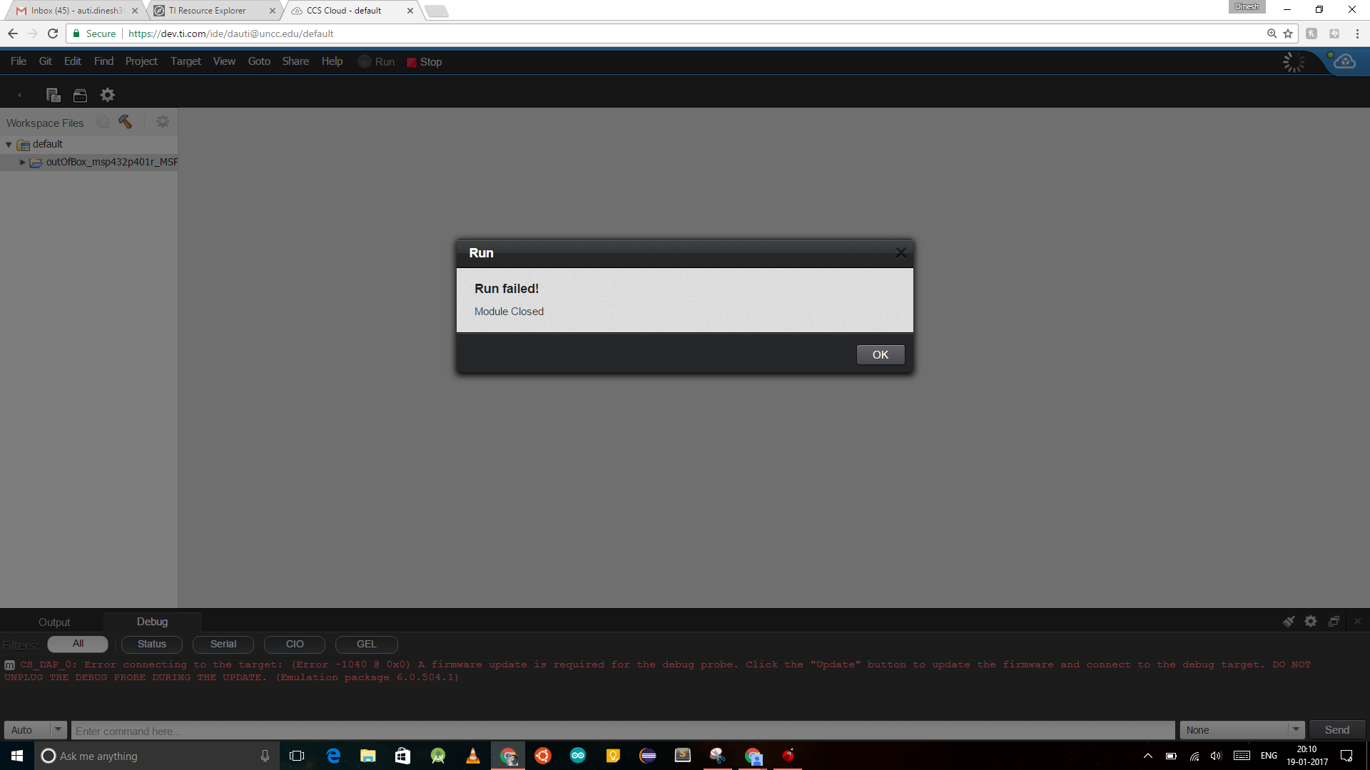

I was helping some students get up and running with MSP432 LaunchPad Rev 2.1 and CCS Cloud. Most were able to go smoothly but a few had a common problem flashing the out of box code example from Resource Explorer to their LaunchPad. This has been on Windows 10 with some newer computers. The LaunchPad properly initializes under ports in the Device manager (2 com ports stating XDS110 like it should). CCS Cloud can also see the com ports from inside the IDE. But when clicking run it returns "Run Failed! Module closed."

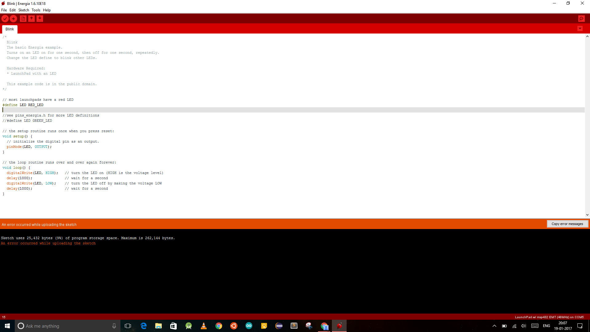

We then tried to use Energia but we also get an error over there "an error occurred while uploading the sketch" and we even went through installing the MSP432 windows drivers manually which makes me start to suspect it might be USB port or Debugger related. These are really new computers which have the newer USB ports so they were not burned out and we tried swapping the LaunchPads and the different ports.

    I see a message in one of the screenshots about needing to update the firmware for the debug probe. Was the firmware update successful?

  • If I remember correctly the students said the firmware was updated correctly, but I did not see that with my own eyes. They even reinstalled the cloud agent and browser plug-in to no avail.
