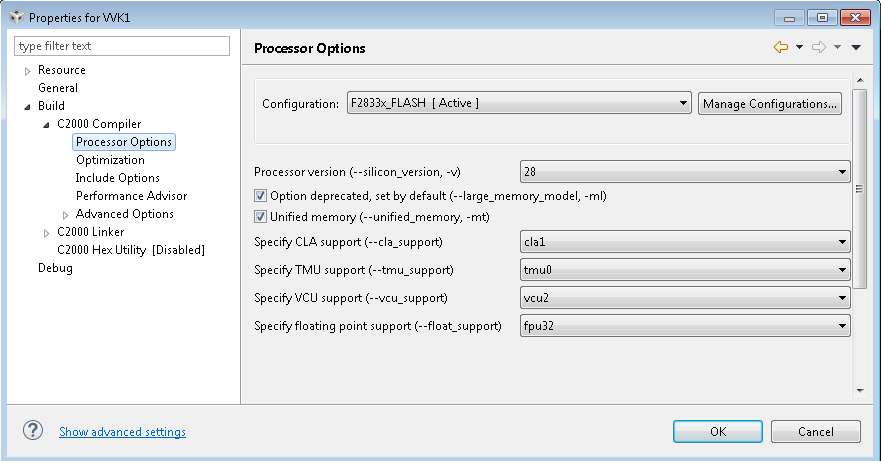

I replaced a sin(x) call with __sinpuf32(x) in my first TMS320F28377S project with CCSv6.1.3 and got an error message
because __sinpuf32 will not be found!
I read the docs and supposed that the compiler will replace a sin(x) call with the TMU function automaticly?
Is this correct?
  • When using that intrinsic, you must use the compiler option --tmu_support
  • I hope I have this:
    see below!

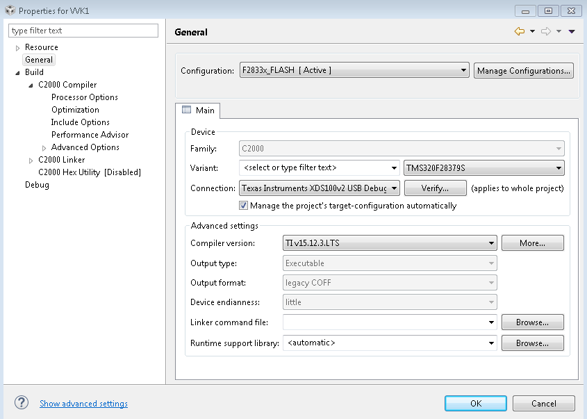

  • Sorry about this, I've made a mistake.
    Now it should work!
    I would try to show, that the options seem to be set correct.
    But the compiling process doesn't know the __sinpuf32() call.
    br Ralf
  • Everything looks correct.  I'm not sure how the results differ from what you expect.
