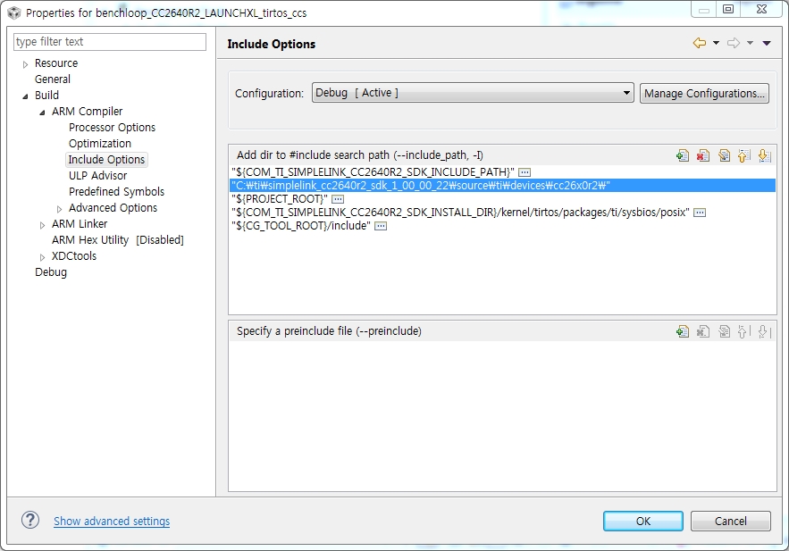

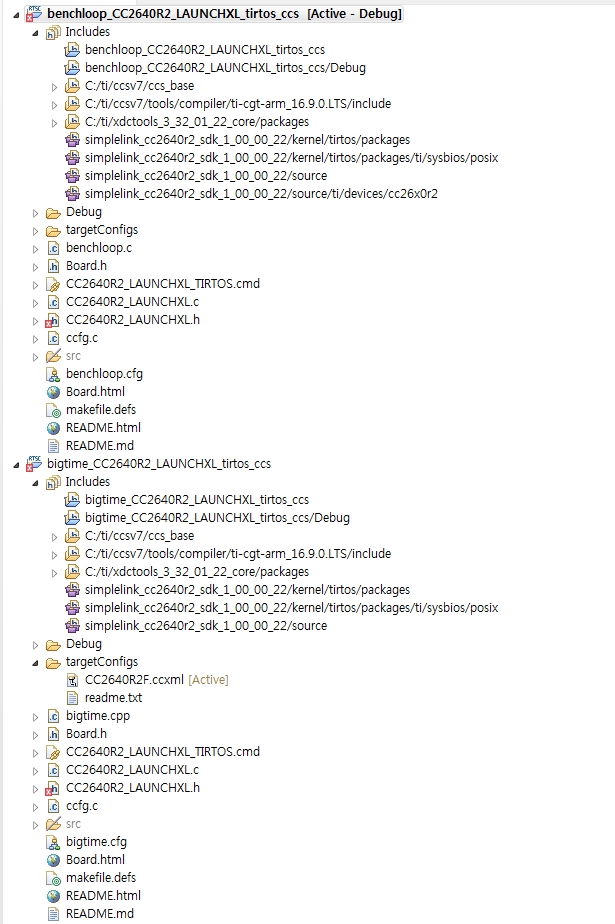

I have some problem
Can not build to CC2640R2
CCS Version : 7.0
Simple link Path : C:\ti\simplelink_cc2640r2_sdk_1_00_00_22
work Space Path : D:\project\...\CC2640r2\workspace
<Make Error MSG>
<Proejct Tree>
<Properties>

    #1965 cannot open source file "ti/devices/cc26x0/driverlib/ioc.h"
    The issue is that the above path does note exist. The correct path is:
    "ti/devices/cc26x0r2/driverlib/ioc.h"
    Looks like a bug with the header file CC2640R2_LAUNCHXL.h on line 54. It is trying to include the header file with the wrong path. If you change it to the below:
    #include <ti/devices/cc26x0r2/driverlib/ioc.h>
    That will work
