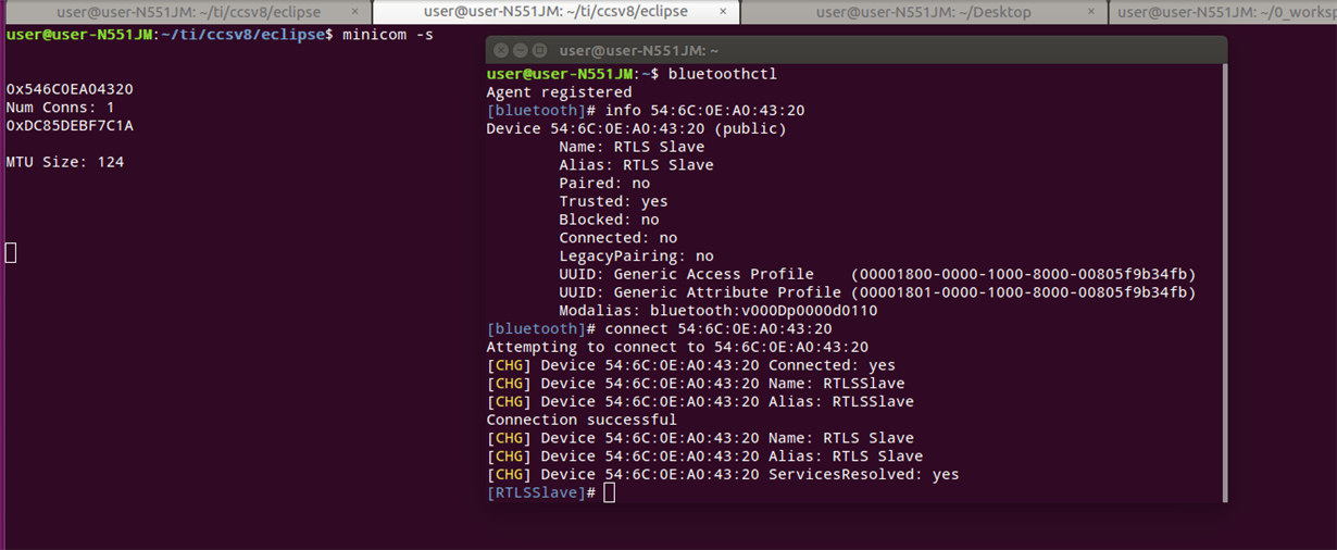

  • update:
    1. Which terminal application are using using (linux's or CCS)?
    Welcome to minicom 2.7
    OPTIONS: I18n
    Compiled on Nov 15 2018, 20:18:47.
    Port /dev/ttyACM0, 11:33:15
    2. Which SimpleLink SDK are you using?
    I tried SDK version simplelink_cc2640r2_sdk_2_40_00_32, and that's the same problem.
    Thanks!
    We have <sdk>/examples/rtos/<board>/drivers/uartecho. The target simplies echos back the character that the terminal sends it. Complete details (baudrate, etc.) are in the readme in the project. Try this and see if you get Rx and Tx. Note: it uses the back-channel UART in the USB/XDS110 connection.
    Todd
  • Hi, Todd
    Thanks for your kindly help!
    RTLS Slave projects is running on the CC2640R2F LaunchPad !
