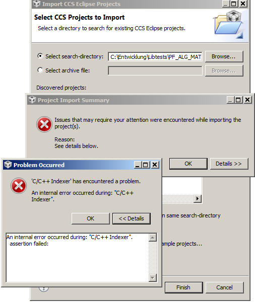

I try to import a static library project in CCS7 which works fine under CCS6, but the import fails (see dialog) and I get an empty project file in project explorer.
Problem are the following entry:
<listOptionValue builtIn="false" value="OUTPUT_TYPE=bios5Application:rtscApplication:staticLibrary"/>
If I remove it, or I change it to:
<listOptionValue builtIn="false" value="OUTPUT_TYPE=staticLibrary"/>
I can import the project.
Problem here is, if I import this project against under CCS6 and I change the compiler version, it will create the "bios5Application:rtscApplication:staticLibrary"
again and I can't reimport it under CCS7.
Can you fix the import problem under CCS7?
