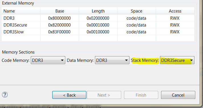

I have created two sections (SECURE_DATA and SECURE_CODE placed at  0x83f00170 adress) to force the linker to place speciphic codeand datas in speciphic section.
I have a c++ object: m_safety, and i allocate it (the datas) in the SECURE_DATA section by using an attribute:
  • SafetyBlock m_safety __attribute__((section("SECURE_DATA")));
I can see the effect in the map file:
SECURE_CODE     0x830f00000      0x170
                0x83f00000                . = ALIGN (0x4)
 *(SECURE_CODE*)
 SECURE_CODE    0x83f00000      0x128 .safetyCpp.o
 *(SECURE_DATA*)
 SECURE_DATA    0x83000170    0x625b8 .SafetyCpp.o
                0x83000170                m_safety
                0x83000c78                m_ci

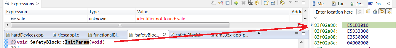

My question: is it possible to map one single c++ object function in this section ?
For exemple, execute in SECURE_CODE section only the lonely InitParam() function in the code below:
Safety.h
class SafetyBlock
    public:
        SafetyBlock(void);
        virtual ~SafetyBlock();
        void InitializeRef(void);  // executing it in standart adress (0x80000000)
        bool InitParam(void);    // I want to execute it in SECURE_CODE section (0x83000000)
Safety.cpp
SafetyBlock::SafetyBlock(void)
SafetyBlock::~SafetyBlock()
void SafetyBlock::InitializeRef(void)
// Init Parameters
bool SafetyBlock::InitParam(void)    // I want to execute it in SECURE_CODE section (0x83000000)
Do anyone know the syntax to force the execution of InitParam in the SECURE_CODE section ?
