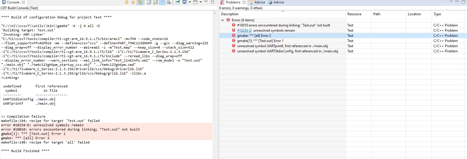

    Now I am left with another issue, maybe you can explain why I get these undefined symbols ?
    This is my main.c, the only file in my project:

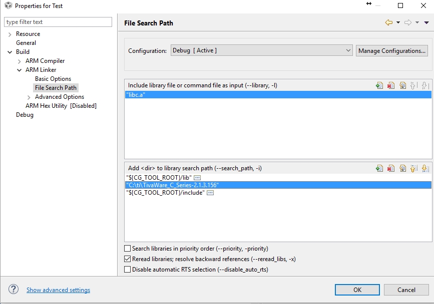

    This would be due to a similar issue but with the library paths.
    Here is a screen shot from one of the examples.  I actually don't like the way this one is setup.  The basic idea is that you list the libraries (.lib) in the top box and then the path to find them in the bottom.  I suspect in your project those paths will need to be adjusted.
    John

    Thanks, unfortunately I am not able to find the lib file, is this a file/package I must download or how do I find it ?
    I do not have the file you have, I searched for "com_ti_tm4c_libraries", as you can see below, I have the DIR path set to the TivaC package but no file path.
    Is "com_ti_tm4c_libraries" the right filename or is it another file I should look for ?
    Do I need to download more or do I just need to find the right lib file ?

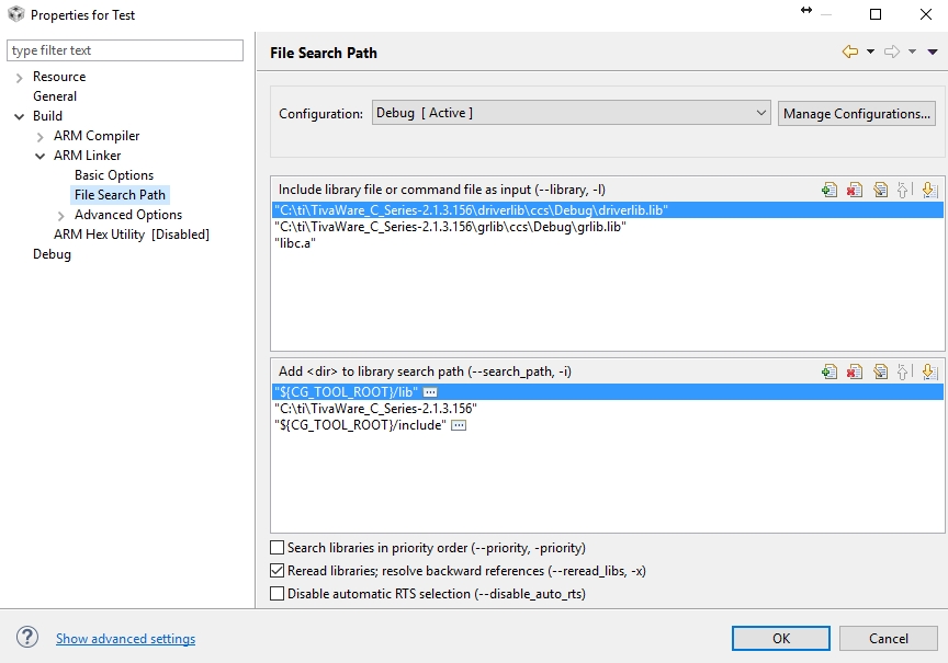

  • I tried this:
    With this being the result:
    I am not sure it is right but only 2 errors remains ?
    Best regards, Peter
  • The paths to driverlib and grlib look ok to me.
    I searched through TivaWare. UARTprintf is defined in uartstdio.c. I found another example (gpio_jtag) that uses that function and it has the uartstdio.c file in the project.
