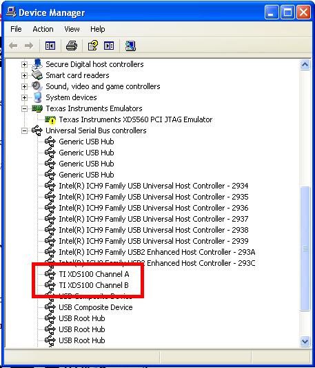

My windows config screen:
I wonder is the XDS100 config text changed?

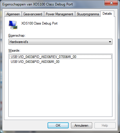

  • I think this is the problem:
    How is it possible that this is changed?

  • Some extra info:
    It a XDS100V2
    I'm using CSS 6.1.1 and 7.1.0 with Emulation package 6.0.579.0
    PID/VID value
