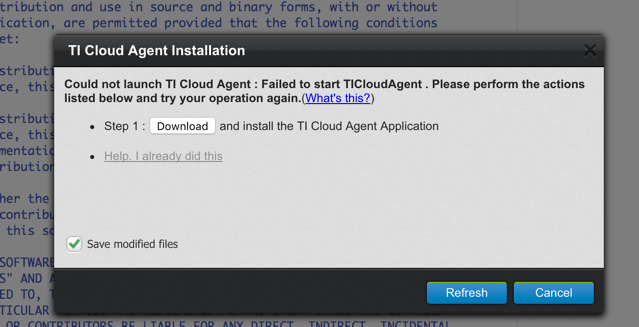

Still cannot run the "hello world" demo - I get an error saying I need to download the TI cloud agent app.

    Click on the Refresh button in the original dialog.
    After that I can debug in CCS Cloud.  Seems like a lot of steps but it just takes a few seconds.
  • Thanks. I did perform all the above steps. Like I said, I installed both the browser extension and the cloud agent.
    I still get that message
  • Did you click the refresh button? Can you send a screen capture?
  • Here is the screenshot (after restarting chrome, same as before)
