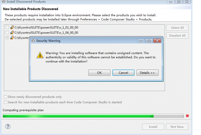

Hi
   I am running CCS V7.2  on win 7 32  sp1 , it works okay .
    Then   I  installed   .Net Framwork4.6.1  , Right after the installation, CCS also work okay wihout any problem;
   But  the next day , when I try to open the CCS , it fails ,and comes out the message " An error has occured, see the log file null "  ;

  • Have you tried cleaning the workspace or starting up a new workspace (as described in this wiki section) to see if that helps?
  • AartiG,
    Thanks for reply!
    I have tried to clean the workspace by deleting the ".metadata " folder in the workspace . But still NG, CCS can not start .
    Yesteday I tried to remove the .netframworks and reinstall the CCS 7.2, still not work; CCS can work normally for once ,But Today I start CCS again, It is NG , CCS can not start with the messags "An error has occured, see the log file null" ; So maybe it is not the .netFramWorks causing the CCS NG;
    So now I can not start the CCS . Where I click the desktop shortcut or the ccstudio.exe in C:\ti\ccsv7\eclipse , There come the message box
    " An error has occured, see the log file null " , the log file I found in C:\ti\ccsv7\eclipse\configuration is list above
    Are there any other log file I can check to figure the problem?
  • Could you please take a look at these two related threads and see if they help?
    https://e2e.ti.com/support/development_tools/code_composer_studio/f/81/t/471617
    https://e2e.ti.com/support/development_tools/code_composer_studio/f/81/t/532151
    In one case, a reboot of the computer was necessary, and in the other it was a permissions issue. Could you check these points and make sure you are running as administrator or with full permissions?
    If those suggestions still do not help, please attach the Eclipse log file, it is the .log file inside the .metadata directory in your workspace folder (if it was generated from the one time you were able to open CCS). The file may be large so please attach it using the "Insert File" icon that will appear when you click on "Use rich formatting" when replying to the post.
  • No, that two does not work;
      The CCS7.2  run okay after  CCS installation.  Then  I install the powersuit 1.07.0.0 and the .NetFrameWork4.6.1,  After that , CCS also works normally . But the next day, after I start my computer( reboot),  I can not open the CCS , Click on the start icon just come the error message . Also running as administrator does not work;
    At first , I think  it is the  .NetFrameWork4.6.1 cause that error ; But after I  delete .NetFrameWork and reinstall the CCS  ; Error coms too. Another  thing I do is install the powersuit1.07.0.0 ,  I do not know whether the powersuit made that error;
      Sorry  I can not  upload the .log file , Error coms that the URL invalid ; So   I past below;
  • I can not upload file . Error coms that URL invalid ; I dont known why ; So I have to copy the log file and past it
