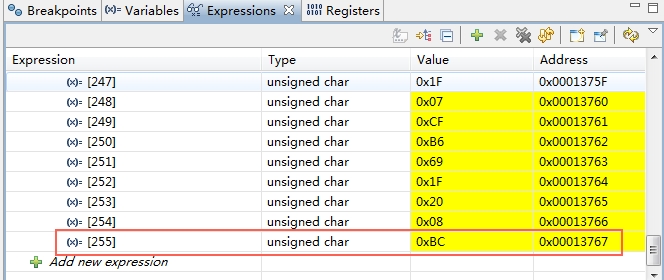

If use -O0 or -O1 the sig_out[255] is 0xBC, it's right.

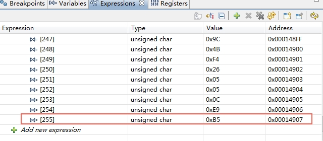

If use -O2 or -O3, the sig_out[255] is 0xB5. it's wrong.
-O3 picture:
-O0 picture:
And this is the attached project. I have checked, the CGT V7.4.20 and CGT V8.1.0 also have this issue. please help me the debug it, thanks!

Yes, Not only sig_out[255] is different. Customer only use sig_out[255] now, so I make it as example.
It have been verified that -o0/o1 array has correct values.

The fix to this issue will be available in v7.4.22, due sometime this month.
C6000 compiler release 7.4.22, which fixes this issue, is now available. Please see this forum post.
