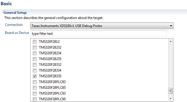

My basic configuration for the control card TMDSCNCD28335 is as shown in inserted image. I am using code composer studio ver.6 emulator, connection I set is XDS100v1
I am getting the following error

I have also tried setting emulator xds100ver2 and ver3 but I get same error.

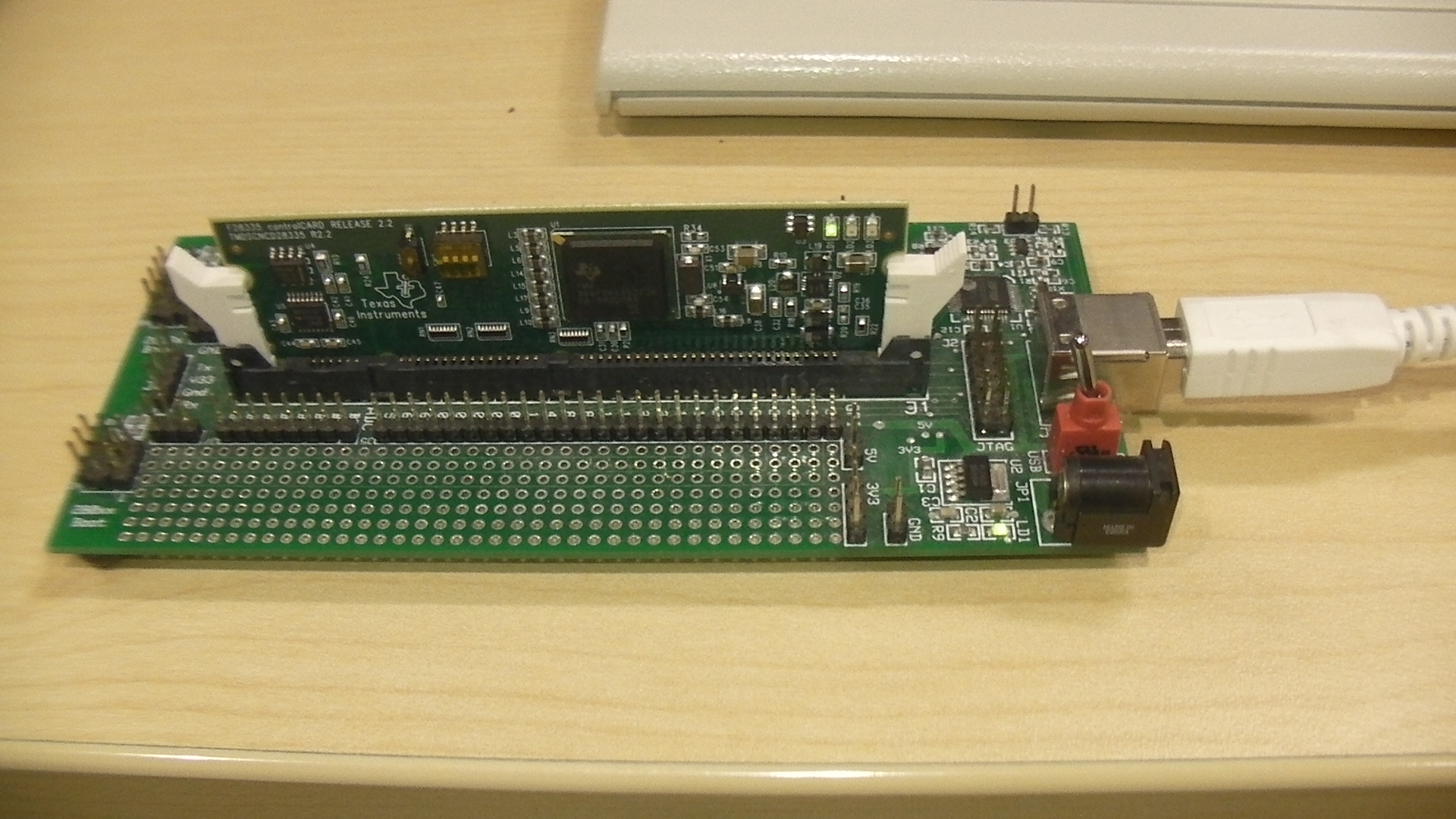

The configuration looks ok, but how are you exactly connecting your TMDSCNCD28335 to your computer?
You should have a baseboard and connect it to your PC with a USB A to B cable as shown in the photograph below:
If you are using the same configuration above, your configuration of XDS100v1 is correct. Don't forget to turn the right red switch to the "USB" position.
The other detail is to double-check if the XDS100 device drivers are being acknowledged by Windows. Check the screenshot at section 2.6 of the page below:
http://processors.wiki.ti.com/index.php/XDS100
Also, check if the cable or the USB port are working properly. An explanation for the error is shown at section 5.1 of the following wiki page:
http://processors.wiki.ti.com/index.php/Debugging_JTAG_Connectivity_Problems
Hope this helps,
Rafael

I have kept the switch on. And connected the control card as shown in the figure. I also checked the setting but it is not same as in 2.6 of the page
It says USB SERIAL CONVERTER A
USB SERIAL CONVERTER B
I am not able to understand the changes I need to do. The error is same.
