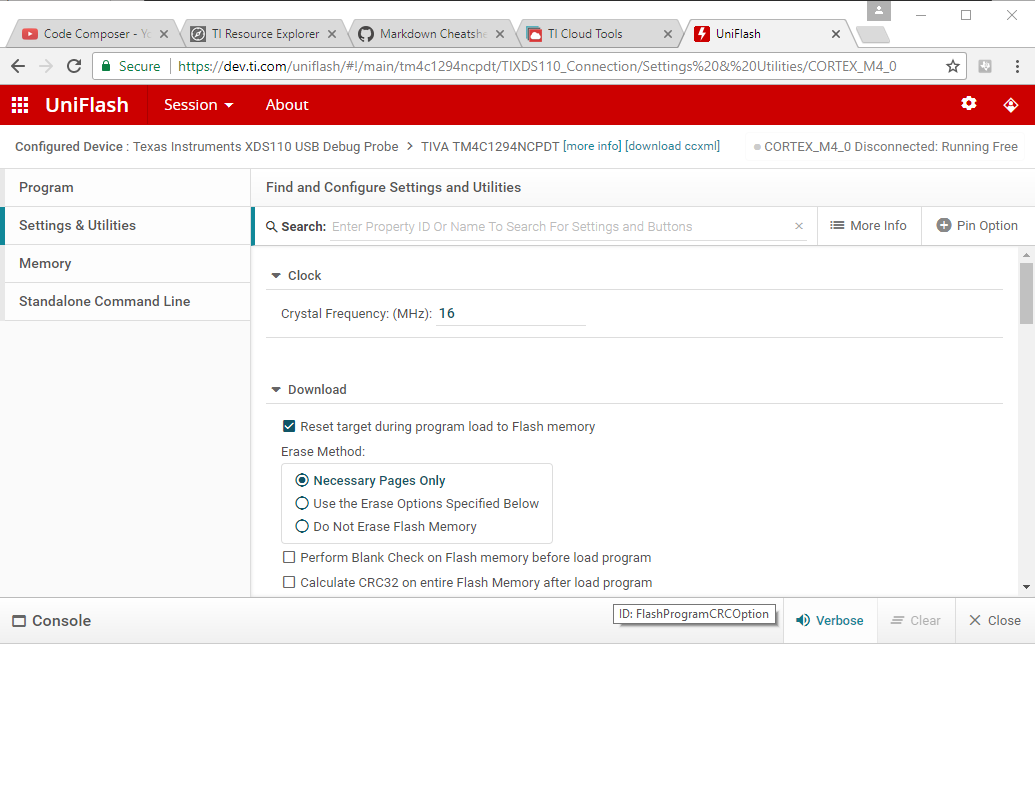

    One detail: at the very bottom of the Readme.txt file there is a method to try to recover a bricked XDS110 without a JTAG debugger - did you try to do that method?

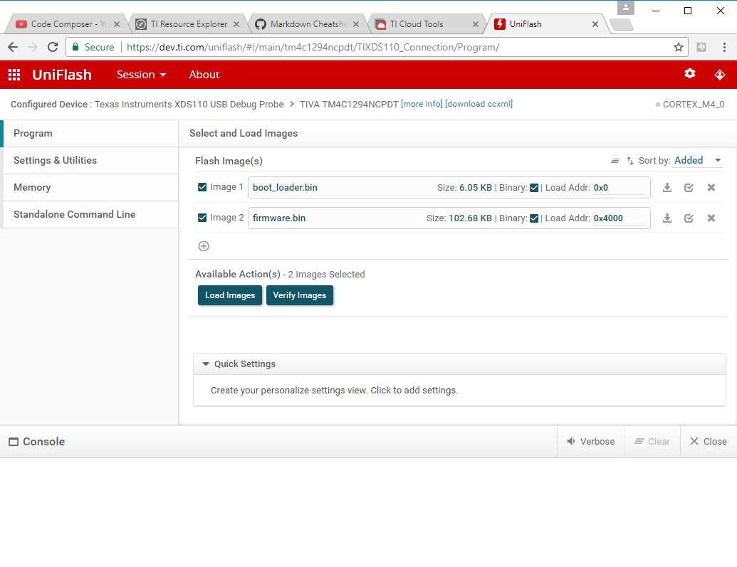

    I didn't test all the steps below myself on a "live" XDS110, but you use Uniflash to do the programming. By going to http://dev.ti.com you can select the device and the debug probe you have connected to your PC:
    You can select "settings" and make sure the settings are suitable for the target device (the XDS110 uses a 16MHz crystal) and only necessary pages are erased during download.
    Then you can load the files and pass the addresses mentioned in the readme.txt file as shown in the screen below.
    After that, click on Load Images and wait for the process to finish.
    You will probably need to disconnect and reconnect the newly programmed XDS110 from the USB port for it to be properly recognized.

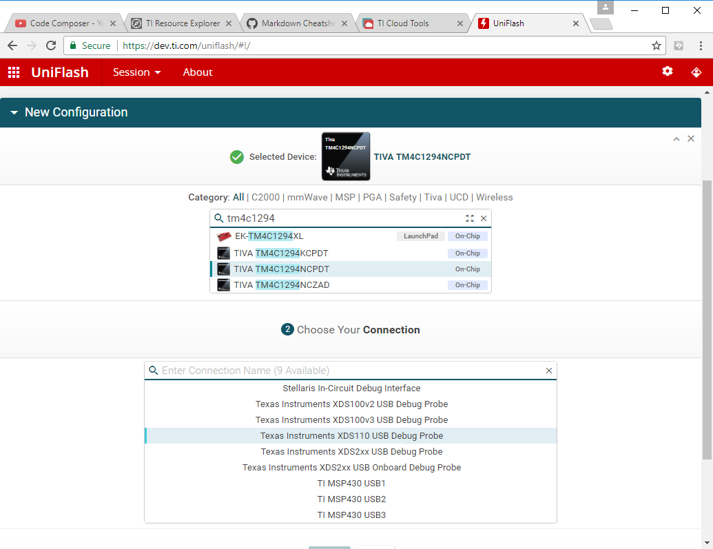

    Yes, I've tried to recover a bricked XDS110 without a JTAG debugger by shorting JTAG header's TDO & GND pins, but it doesn't seems to work.
    So, I borrowed another XDS110 debug probe to rescue my XDS110 debug probe from someone else.
    Like you said, LM Flash does not support XDS110 debug probe, so I tried the UniFlash that you suggested, and successfully loaded 'boot_loader.bin' into my XDS110 debug probe. After that, I can use 'xdsdfu -m' and 'xdsdfu -f firmware.bin -r'  commands to flash itself's firmware.bin file. So, now my XDS110 debug probe is back to normal!
    Thanks again for your help!

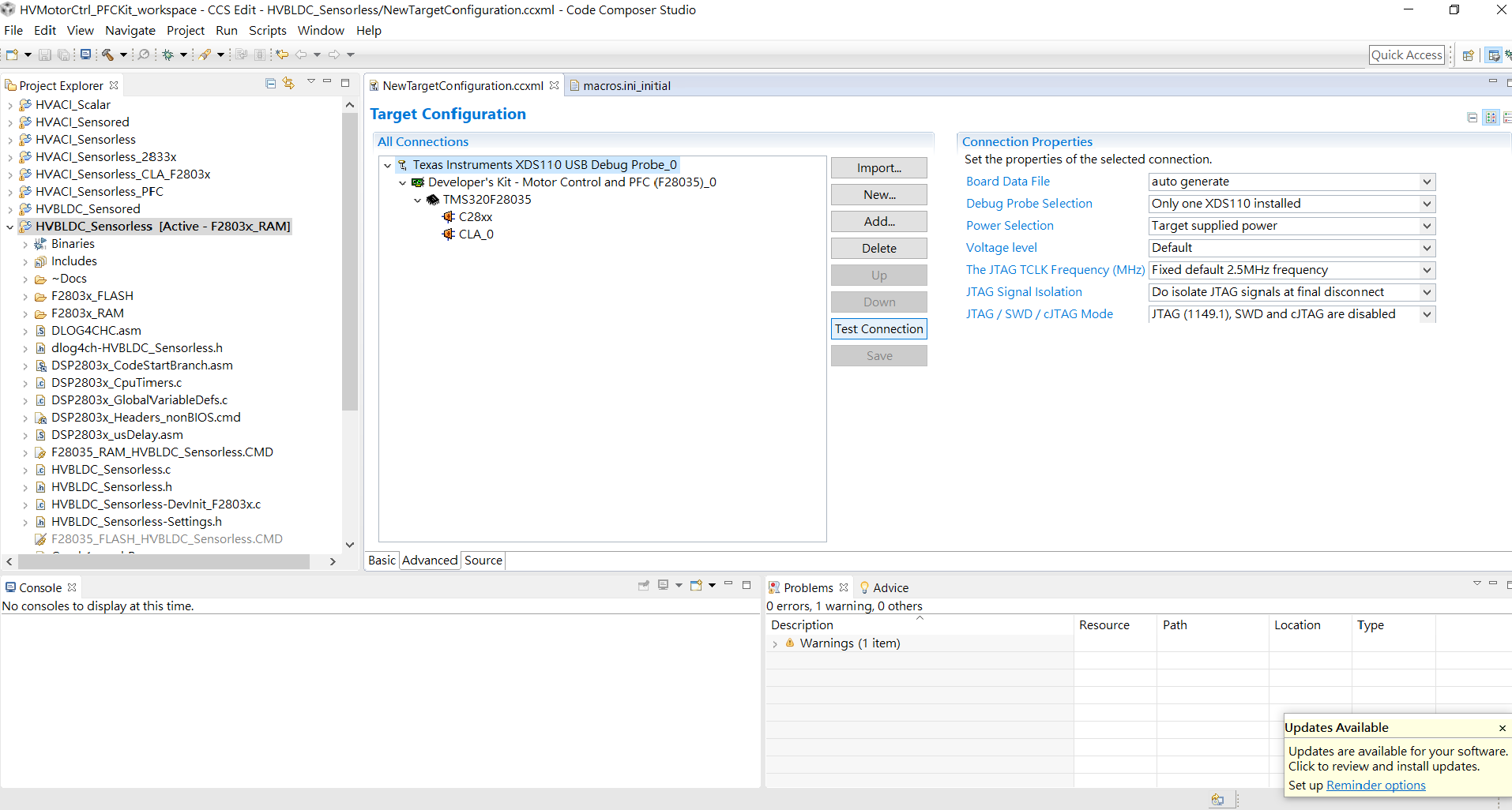

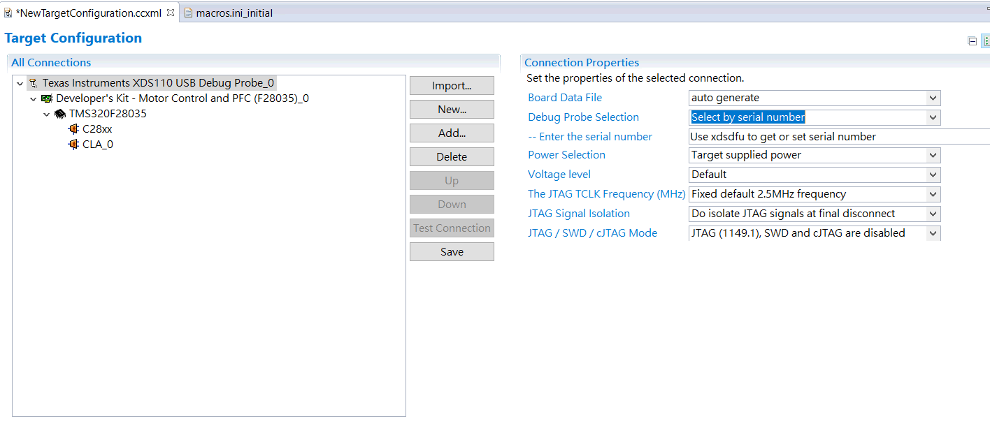

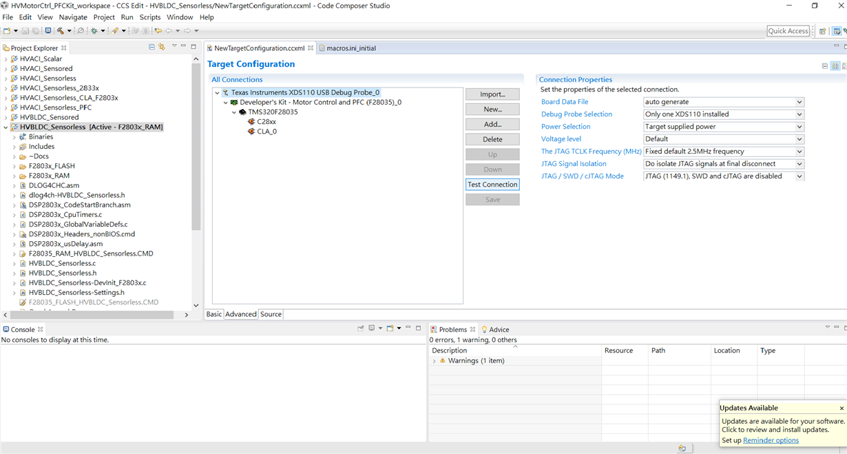

    I am having hard time connecting to TMDSHVMTRPFCKIT with XDS110 debug probe, not sure if you are familiar with TMDSHVMTRPFCKIT.
    I have TMDSHVMTRPFCKIT's Isolated XDS100 USB JTAG Emulator connected for the board's M3 section's power source, and the Input for 15VDC power adapter connected to power up the TMS320F28035 ControlCard.See attached picture:
    I have UniFlash detected two debug probe, my XDS110 and another one is TMDSHVMTRPFCKIT's onboard USB JTAG emulator XDS100v2, see attached picture.
    And, here is my CCS (CCS Version: 7.1.0.00016) setup for the connection, see attached picture.
    And, when I press 'Test Connection' button, I receive the following error message.

    The value is '-233' (0xffffff17).
    The title is 'SC_ERR_PATH_BROKEN'.
    The explanation is:
    The JTAG IR and DR scan-paths cannot circulate bits, they may be broken.
    An attempt to scan the JTAG scan-path has failed.
    The target's JTAG scan-path appears to be broken
    with a stuck-at-ones or stuck-at-zero fault.
    [End: Texas Instruments XDS110 USB Debug Probe_0]
    Not sure if there is anything wrong with my CCS setup or the board's setup, or if you know where I can find answer for this.
    Thank you!
    Yu Hung
  • Yu Hung,
    The issue you are seeing now can be caused by the many jumper configurations on your development kit. In the kit I have here (similar to yours but probably an older version) I have to set up jumpers on the M3 module to properly connect using an external JTAG debug probe instead of the built-in XDS100.
    Check your kit's Hardware Guide and see if you can find its proper jumper settings - PDFs of these Hardware Guides are supplied with controlSUITE under C:\ti\controlSUITE\development_kits\HVMotorCtrl+PfcKit_<version_of_your_kit>\~Docs
    Hope this helps,
    Rafeal
  • Dear Rafeal,
    The issue is resolved by putting a jumper on [Main]-J9 with my version of HVMotorCtrl+PfcKit_v2.1, and both external JTAG debug probe and internal built-in XDS100v2 need to populate [Main]-J9 jumper.
    The reason I am having hard time with this is because the TMDSHVMTRPFCKIT ships with no extra jumpers for empty jumper slots, such as [Main]-J9 jumper. I got my spare jumper from my very old hardrive disk.
    Anyway, thanks alot for your help!
