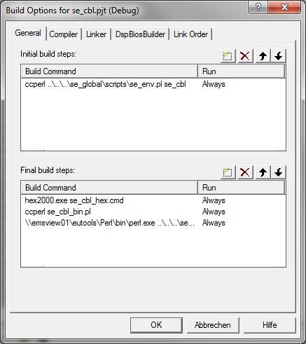

4         Initial and final build steps
General Dialog of old CCS3.3
  • Where do we have to place initial and final build steps with CCS5.5?

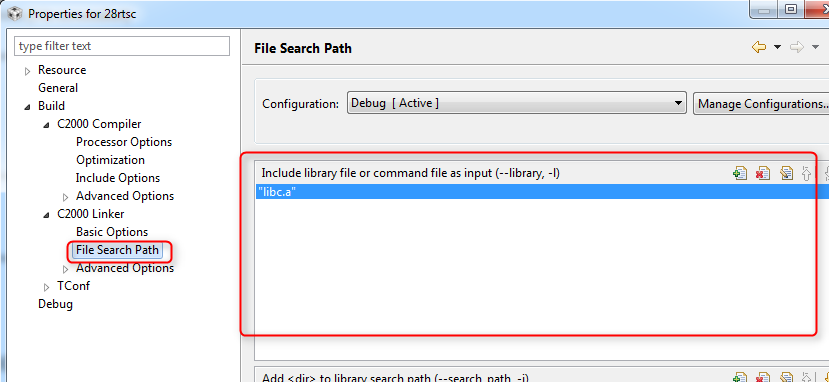

    We are using separate “*.cmd” files instead of 2809_RAM_lnk.cmd (chosen by import). (4 in screenshot)
    • Where do we have to place them in the linker dialog??
    The option is under the "File Search Path" options under the C2000 Linker project properties.
    But you can simply just add the cmd files to the project instead (this is more common)

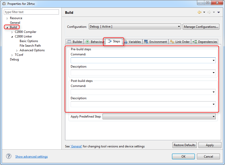

    See the screenshot below:
