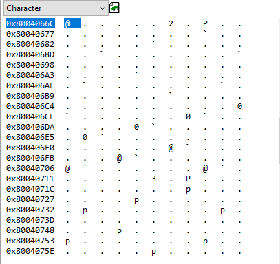

I am developing a data translation method in CCS and I am facing the following issue.
Given : A header file consisting of typedef struct with char* variables.
Requirement : To read values of these variables from the header file.
Problem : Some of the values read from the variables are not the same as in the header file but seems to be some kind of a junk. For ex. the symbol "@", "^8DH0L|***" , "ÿÿÿÿÿÿÿÿÿÿÿÿÿÿÿÿ"
From my observation, the values stored in the memory browser itself are wrong and hence the read values are unexpected.
for example,
In the header file, value of a variable char * label_id_attr = "032" at one point , but the value in memory browser is "@"
Screenshots for the memory browser:

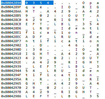

At another point, the value stored in the variable in a different struct, char * label_id_attr = "0354" and the memory browser has the same value.
this is weird...

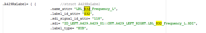

    Header file looks like this,
    A429RxLabel is inside the testModule (parent container). This is just one block in rxlabel, there are many similar to this,

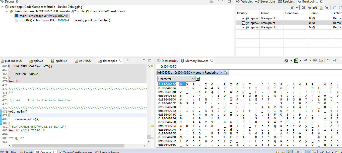

  • Hello Chester,
    The memory browser shows the correct value when it reaches main,
    Can see below, the address 0x8004066c has "032"

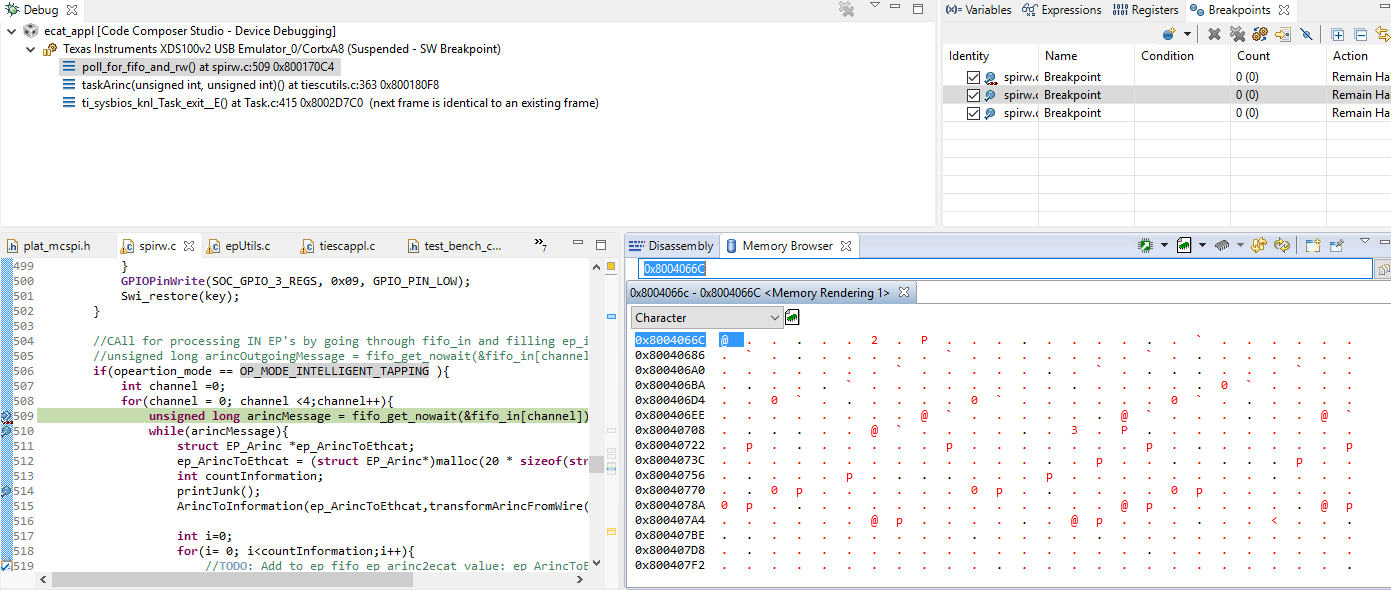

    But after the program is run, the value gets corrupted,
    So do you think there is some problem with the code?
    It does appear to be a software problem which causes the memory to be overwritten.
    Once the program is at main set a Hardware Watchpoint for writes to address 0x8004066c and then run the program. If the software is overwriting that address then the Hardware Watchpoint should identify the cause, by breaking on a write.
    See Configure a Hardware Watchpoint (the referenced Wiki page was written for an ARM Cortex-M4, but should be applicable to a Cortex-A8)
  • I could see, a part of the TI code overwrites the memory,
    I have attached the c file which is responsible for overwriting the memory,
    the part of the code in the code file which overwrites (function relocate_reload_code()) is as below

    The header is saved in the memory ranging from  0x800404b8 to 0x80048d23.
    And the above code overwrites from 0x800404b8 to 0x800412cf during the iteration itr = 302 to 1204.
