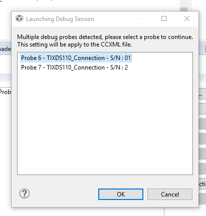

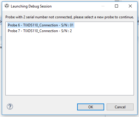

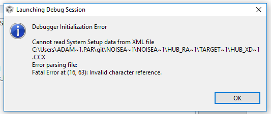

I have been patiently awaiting this new release (7.3) so as soon as I saw it I was all over it. I really love the new dialog for when target config doesn't match hardware but it appears to be trying to modify the target config and failing. Also the serial never seems to match even though it's entered correctly. The hardware is a pair of CC1310 if that at all matters.

Cannot read System Setup data from XML
Serial bug?
and the target config becomes this mess:
<?xml version="1.0" encoding="UTF-8" standalone="no"?>
<configurations XML_version="1.2" id="configurations_0">
<configuration XML_version="1.2" id="Texas Instruments XDS110 USB Debug Probe_0">
<instance XML_version="1.2" desc="Texas Instruments XDS110 USB Debug Probe_0" href="connections/TIXDS110_Connection.xml" id="Texas Instruments XDS110 USB Debug Probe_0" xml="TIXDS110_Connection.xml" xmlpath="connections"/>
<connection XML_version="1.2" id="Texas Instruments XDS110 USB Debug Probe_0">
<instance XML_version="1.2" href="drivers/tixds510icepick_c.xml" id="drivers" xml="tixds510icepick_c.xml" xmlpath="drivers"/>
<instance XML_version="1.2" href="drivers/tixds510cs_dap.xml" id="drivers" xml="tixds510cs_dap.xml" xmlpath="drivers"/>
<instance XML_version="1.2" href="drivers/tixds510cortexM.xml" id="drivers" xml="tixds510cortexM.xml" xmlpath="drivers"/>
<property Type="choicelist" Value="4" id="SWD Mode Settings">
<choice Name="cJTAG (1149.7) 2-pin advanced modes" value="enable">
<property Type="choicelist" Value="1" id="XDS110 Aux Port"/>
</choice>
</property>
<property Type="choicelist" Value="1" id="Debug Probe Selection">
<choice Name="Select by serial number" value="0">
<property Type="stringfield" Value="01������" id="-- Enter the serial number"/>
</choice>
</property>
<platform XML_version="1.2" id="platform_0">
<instance XML_version="1.2" desc="CC1310F128_0" href="devices/cc1310f128.xml" id="CC1310F128_0" xml="cc1310f128.xml" xmlpath="devices"/>
</platform>
</connection>
</configuration>
</configurations>
