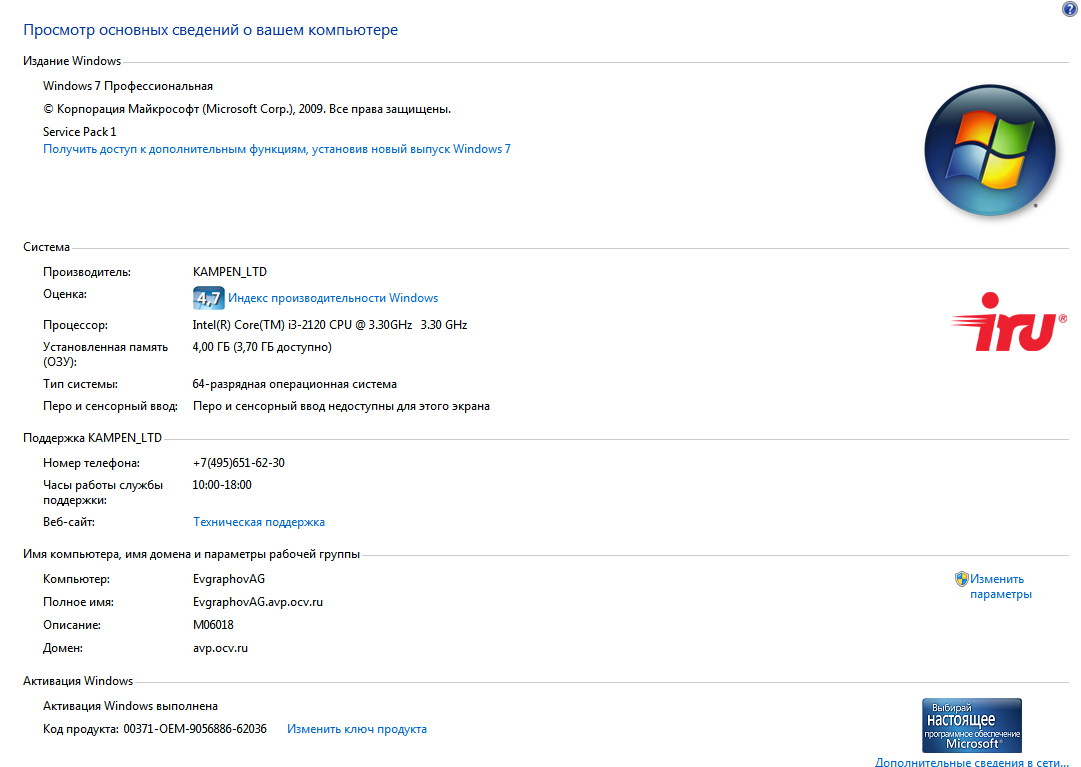

    Can you verify that Control panel -> All Control Panel Items -> System shows that the service pack installed is 1?
    Sorry for the repeated checks, but this failure has me stumped.
    Danish
  • Hello Danish!
    So sad that logs couldn't help. It should be due to wrong update, but earlier I didn't face to any problems.
    Ok.
    If I understand correctly, you want to have a look at the window of the system information.
    I made 2 screenshots:
     1. Information system;
     2. Updates list.
    Screenshots attached.
    Thank you for your patience.

  • Hello Danish!
    I have 2 news:
    1st: Debugging installer behaves the same as others, i.e. after starting I see the same message box about the error.
    2nd: I found out the reason of this problem. This is partly my fault. Usually I use by file manager like norton commander and when I've tried to launch an installer from the Windows explorer (not from Unreal commander, which I use) I got a successful result.
    I apologize for that.
