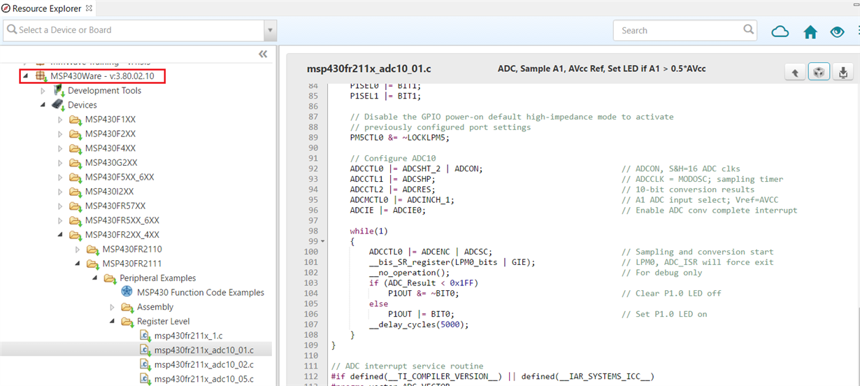

  • Hi Johns,
    The problem has been resolved after update to install v3.80.02.10. Many thanks for your feedback to the software team.
