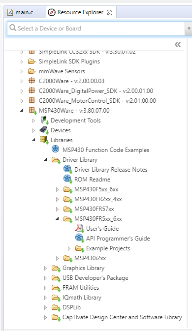

  • Hi
    I am using the CCS  Version: 9.0.1.00004
    Click the View--->Resource Explorer and I can find the driverlib like below
  • I have the same, MSP430Ware is installed under Resource Explorer. But when creating new project, there is no option of using MSP430 DriverLib template, and no option of importing DriverLib to existing project, which is what I want.
