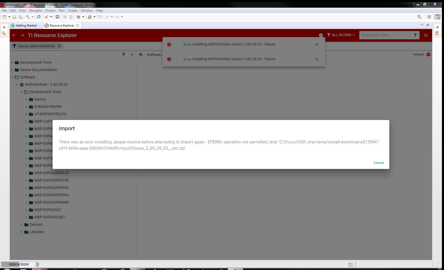

I have attempted to install MSP430Ware version 3.80.09.03 using Resource Explorer.
Install utility downloads file to ..ti\ccs930\tirex-temp directory and does a self-extraction and install of software

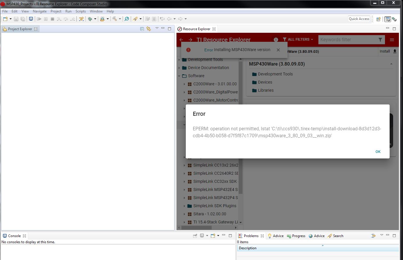

I continually get an error message:    Error   Installing MSP430Ware version 3.80.09.03
clicking on Error     reveals what appears to be a permissions error....

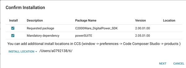

    Lets try changing where MSP430Ware is going to be installed.  In the install dialog that pops up there is a selection at the bottom where you can specify where the package will be installed.  This is for a different package as I already have MSP430Ware installed.
    Change the install location to be in your user folder.  There should be an item in th list that is <user folder>/ti.  If that is not there then you can add that loation in the CCS preferences dialog in the location noted in the dialog.  By doing the temporary directory will also be created in this location.  If the problem is permission related this should solve it.

    I even un-installed all the CCS and other related TI software and retried using ver10 (released last week) with same error appearing.
    CCS loads up and works fine.
    I imported the Energia Core without issue using the resource explorer Package Manager.
    But when I attempt to install the MSP430Ware, it goes through the download phase OK, install to a directory as specified, but fails during the extraction phase.
    same error occurs each time.....

    In that last dialog it is showing as using the C:\ti\ccs1000 folder as the base location for the temporary files.  Did you change the setting I showed to install in your user folder?
