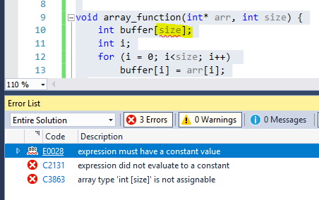

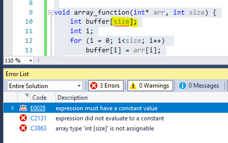

    Just fyi for anyone else who comes across something like this, I think the root cause of this problem was that I was trying to declare a local "automatic" array variable with a non-constant array size. For example:
    void array_function(int* arr, int size) {
    	int buffer[size];   //works...sometimes!
    	int i;
    	for (i = 0; i<size; i++)
    		buffer[i] = arr[i];
    int main(void)
    	const int n = 5;
    	int a[] = { 1, 2, 3, 4, 5 };
    	array_function(a, n);
    	return 0;
    Interestingly, g++ does not complain about it and it runs as expected:
    g++ -std=c++11 -Wall test.c
    But Visual Studio catches the error:
