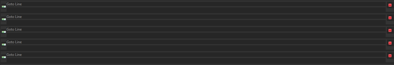

I suddenly have a bar which is running in the background continuously and doesn't seem to do anything and can't be deleted -
is there some way of removing it?
Here's a screenshot:

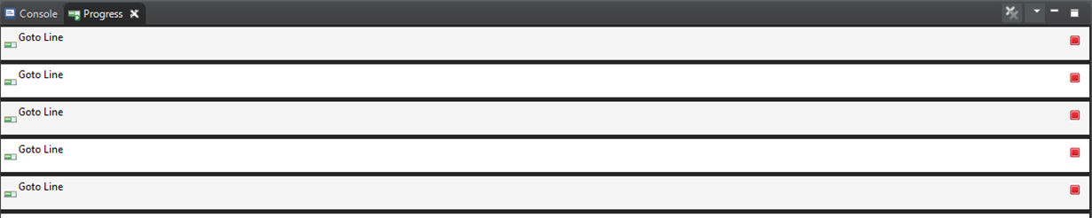

  • At startup it doesn't appear, but sometime after it does.
    in progress bar it seems like shown below, and pressing the red stop button doesn't change anything.
    Might it be connected to the "quick search for eclipse" add-on which I have installed?
  • It seems that the issue derives from the remote search.
    When pressing on some of the results which appear in the in remote search results window
    the file containing the specif result displays the beginning of the file, instead of the specif line where
    the searched term appears. Each attempt trying to open such a result opens another "Goto Line" bar as seen above.

    Neither Ki or I have been able to reproduce the Goto Line message. We have a feature to "Run to line" but when that gets stuck the message in the Progress view is "GEL Expression: GEL_GO(address)". I tried that out by telling it to run to a place it cannot reach. Similarly when I use remote search it shows "Search" in the progress view. Thus it seems like something else is causing it to appear.
    Remote search is used to search for files anywhere in your file system. You use the folder field to specify where you want to search. You control the file extension of files that it will search. By default it is set to search * so it will search all files, including hidden files.
