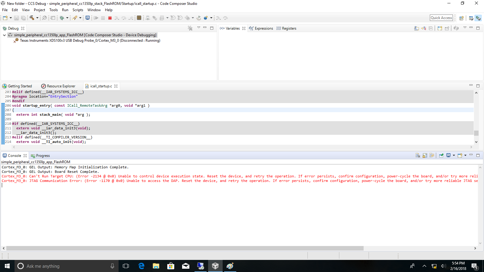

  •  hi desouza,
    Now i am using SmartRf06 Evaluation Board to debug simple peripheral example to my custom board(CC1350)using 10 pin arm cortex debug connector,  i am using xds100v3 usb debugging probe. I can able to flash stack but when application is going to flash, i got an error. The error is shown in the figure. Error -2134 @ 0x0 & Error - 1174@ 0x0. What are the possible ways to solve this issue.
    Thanks & regards
    haricharan
  • Haricharan,
    The error you are seeing is shown in the link below:
    software-dl.ti.com/.../ccsv7_debugging_jtag_connectivity_issues.html
    It is interesting the error happens after you are able to flash the stack - usually the application is what causes the device to lock the processor core and cause the error shown. In any case, can you issue a mass erase using either CCS or the LMFlasher utility? Perhaps it could have been a simple glitch on this load.
    Another problem is if the core stack is somehow causing the device to fail - unfortunately this is something I can't evaluate from here, but perhaps some power glitches on the board or the stack itself is misconfiguring the pins of the device? (If I recall correctly the JTAG pins are multiplexed with other functions).
    At any rate, this does not seem to be a problem of the connection itself nor the XDS100v3, as you are able to connect at least once and flash the device.
