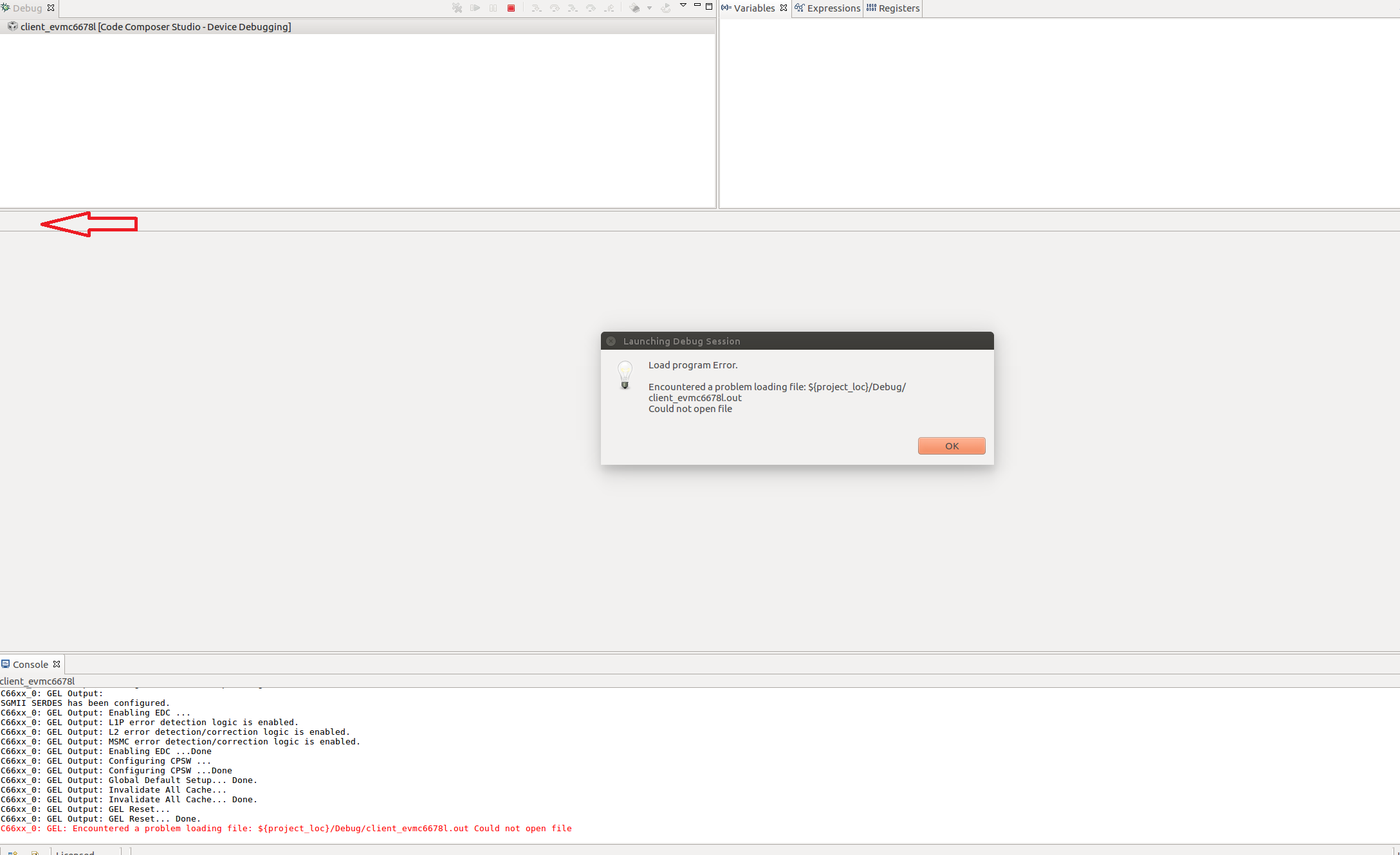

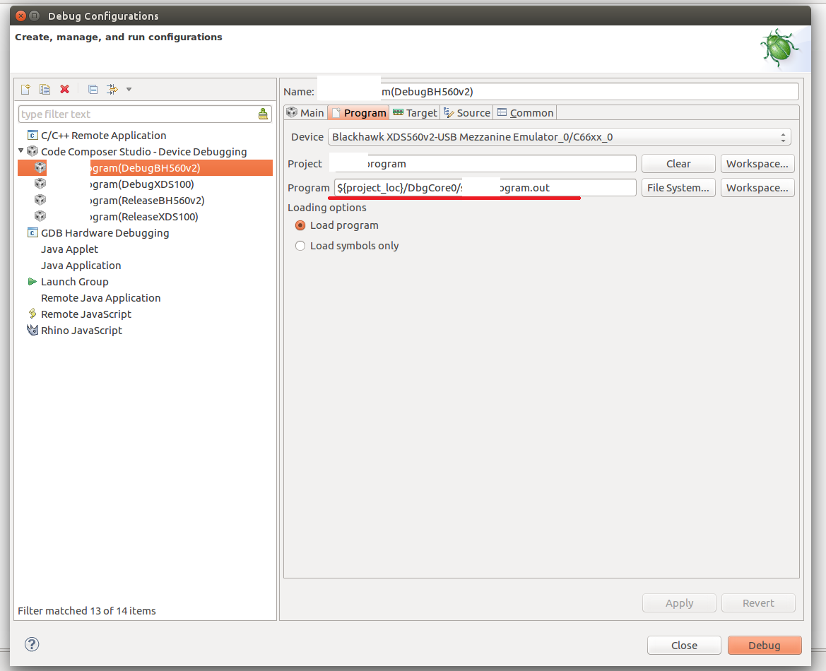

I use CCS v5.5 on Linux and I have a strange problem on our TMS320C6678 dev kit:
For a reason we need to use ${project_loc}/... path in a debug configuration. We have to load all 8 cores this way. When I close all windows containing any code for a specific project, then try to load out files with this path, I get an error: "Encountered a problem during... ${project_loc}/dbg/... .out". Vice versa, when I do have some of the project's code open, no error occurs and I am able to load the out files to the cores.
Yes, I have always set my project "Active", as seen in the Project Explorer. When all windows with the code are closed, I get this error. Yes, I know of ${PROJECT_LOC}  vs  ${project_loc} difference and stuff.
I use kit6678BH560v2_USB.ccxml config for BH560v2.

1. Debug config:

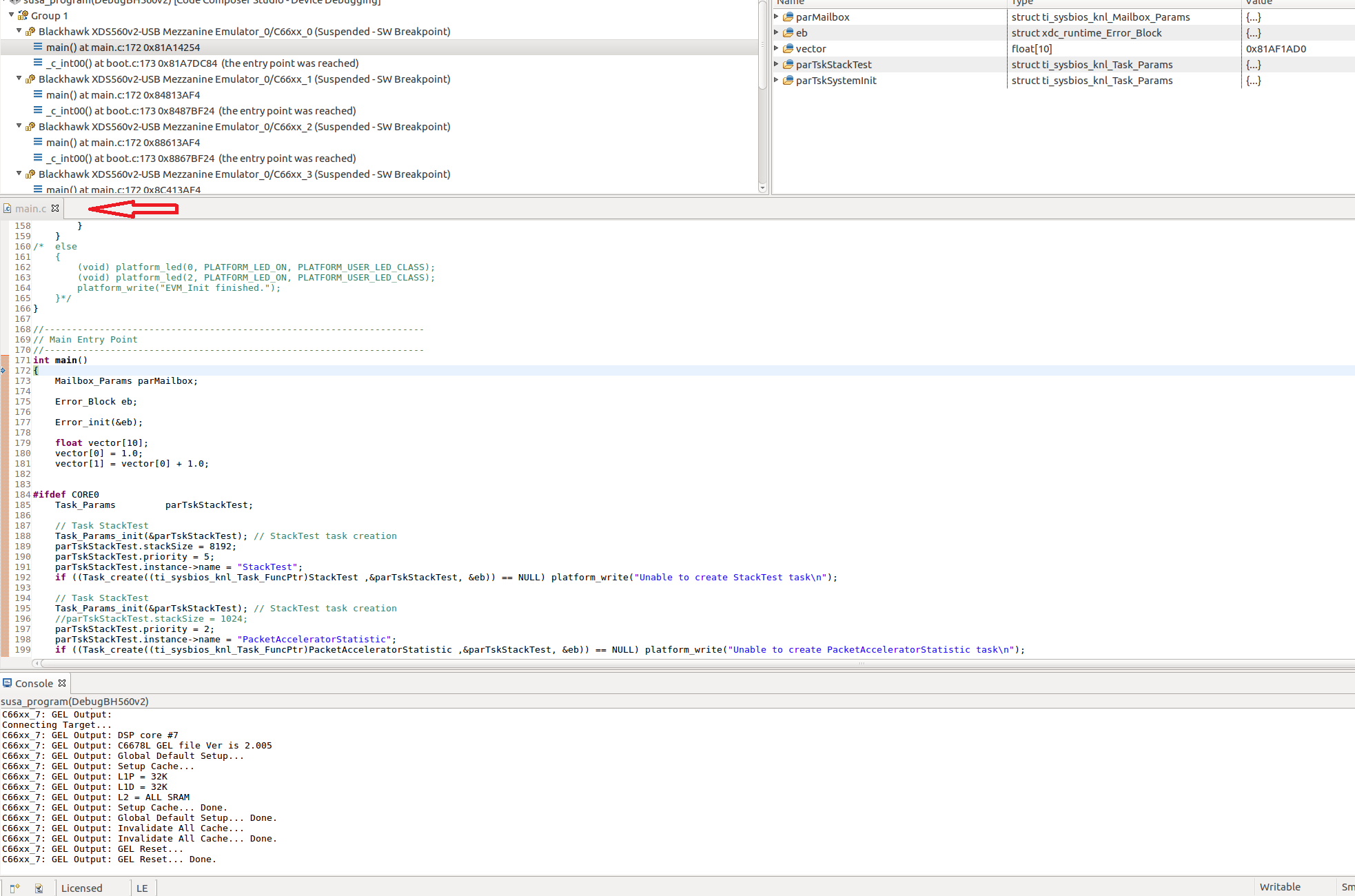

2. It works when main.c is open:

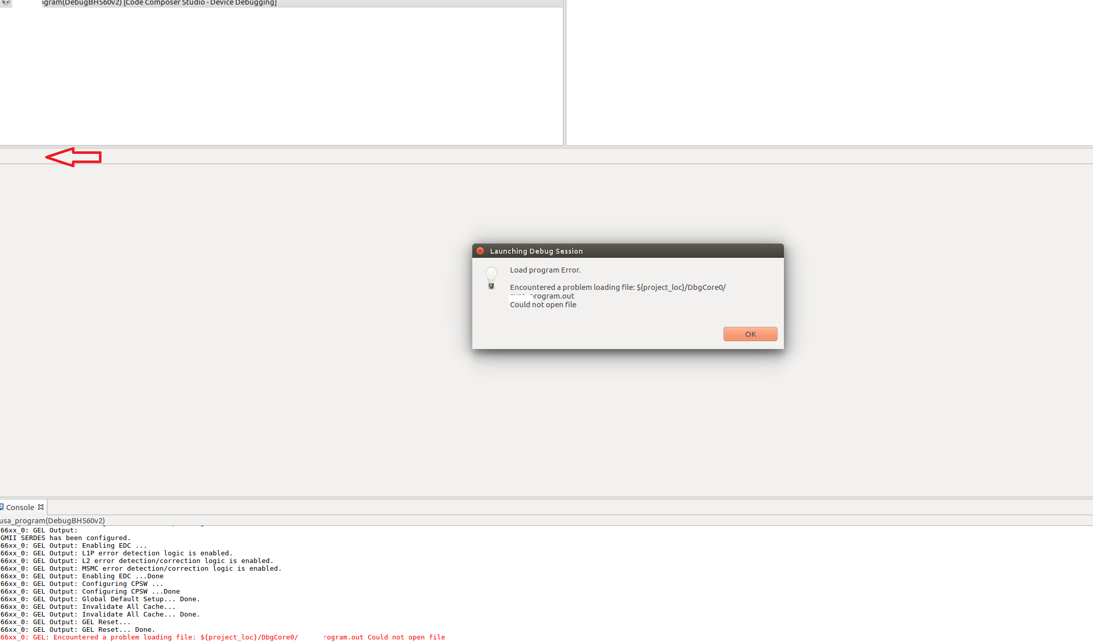

3. It does not work, when all code is closed:
4. The same situation with (reproducible) client_evmc6678:
    It seems strange that having source files open in the editor would impact whether the Program field syntax is accepted or not.
    Are you sure that specifying ${project_loc}/dbg/file.out in the Program field works consistently when source files are open? Does this work also when launching the debugger using the Debug (green bug) button?

  • Yes, I am sure of that, 100% correct during several tests, when I closed windows with any code, problem occured again. I do not use the "green bug" button, since we have many different debug configurations for different uses (debug/release paths etc).

  • I observed a couple of odd things when trying to use ${project_loc}/ with CCS 7.4, but ignoring that I was able to reproduce the behavior you described.
    I have filed bug # CCSIDE-3296 to track this issue so an engineer can take a closer look. Feel free to track its status using the SDOWP link in my signature. The link will be updated with this bug report in about an hour.
  • An engineer looked into this issue and here are some additional comments on this topic.
    The variable ${project_loc} is a built-in Eclipse dynamic variable, which should resolve to the current "context" project. However, since it does not work when just the project is selected, it is possible that something else takes focus when a debug session is launched, thereby the project_loc variable is not getting resolved. When a source file is open that serves as current context and then project_loc gets resolved properly.
    An alternative would be to use workspace_loc instead of project_loc. And a few other variables, as shown below, could also work (hello is the name of the project in the examples below):
    ${workspace_loc:/hello}/Debug/hello.out
    ${project_loc:hello}/Debug/hello.out
    ${resource_loc:hello}/Debug/hello.out
    Unfortunately we do not have direct control over this as it is a feature we inherit from Eclipse. Hopefully using one of the above alternate variables is a viable solution for you.
