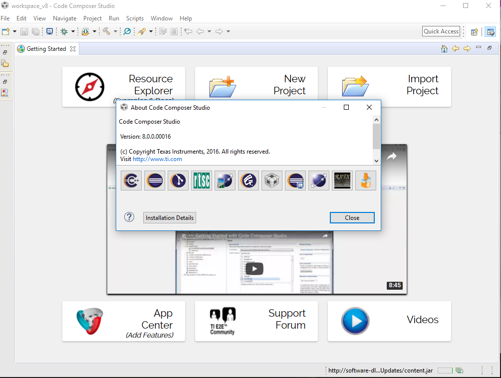

  • Thank you. Your file looks fine. Can you provide your configuration details? You can go to:
    Help->About CCS : Installation Details @ Configuration tab
    Copy and paste the configuration data to a text file and please post the file here
    ki
  • I can't. CCS doesn't start up.
