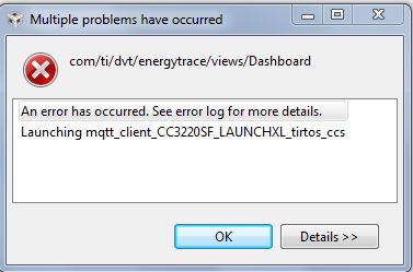

I was working on a project using CC3220SF launchpad when all of a sudden I could no longer Debug any project in my workspace. When I tried to debug a project from another workspace, debug session would run. This is the message that appeared every time I would debug a project. On the debug icon it comes as "Debug mqtt_client_CC3220SF_LAUNCHXL_tirtos_ccs (already running)".
Can someone help me in removing this error. I am positive that I have not changed any settings.
Regards Shlok.

  • Please check item 7 at this link for suggestion to resolve this type of error.
  • Hi Aarti.
    Thanks for the tip. I deleted the metadata folder and imported the projects from workspace again and it works. Thanks a lot. However sometimes the C/C++ compiler hangs while trying to save the project and then I cannot do anything. So I have to take a backup of everything and import that backup project again. Can you tell me how I can avoid that??
