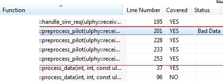

Hello , we  use CCS Tools ->Hardware Trace Analyzer -> open file  to import a .tdf file , and UlDspKeCpu.out , but  line Number didn't display all code run , just display some of the lines . how can we get all line number covered display in ccs ? Thanks!
    The screenshot you sent seems that you are performing function Code Coverage. If you open the CCS Help, you can search for "Instruction Coverage" to learn how to access the actual instruction coverage.
    One detail, though: I see a status message that indicates "Bad Data". If you see many of these messages, there is a possibility the data collected is either incomplete or was corrupt during data collection. This can happen due to many reasons such as too much data throughput, insufficient buffer size or any potential delays on the host PC.

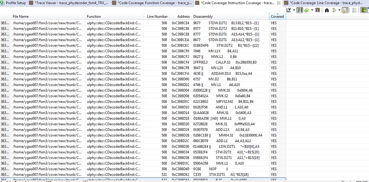

    For Instruction Coverage, for example ,C++ code  Line Number 508   related to many lines for assembly instruction , as i didn't know assembly instruction , how can i count this to C++ code , from CCS we can only know line 508 and 521 run, but exactually , in c++ code  line 509 ~ 521 also run , we want to get the coverage for C++ code.  Thank you!
    I haven't performed Code Coverage on C++ code but, per your description and the Trace results, it seems that your code may be highly optimized, which would cause these apparent inconsistencies in execution.
    Can you try to either disable optimization or gather the trace information in another part of the code that is not optimized? You can also disable optimization in a single source file. For details on how to do that, check:
    software-dl.ti.com/.../ccs_project-management.html
    This will allow you to have visibility on how the code is behaving at source level.
