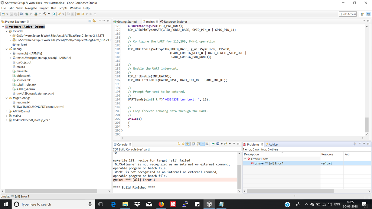

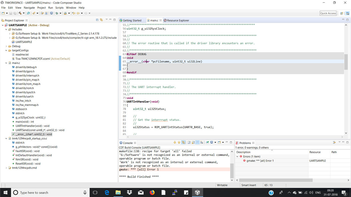

It looks like you have spaces in your workspace folder name. It also looks like your workspace folder has a special character "&". Both are not recommended: software-dl.ti.com/.../sdto_ccs_build-errors.html
Please try using a workspace folder without special characters and with no spaces in the name (and path).
