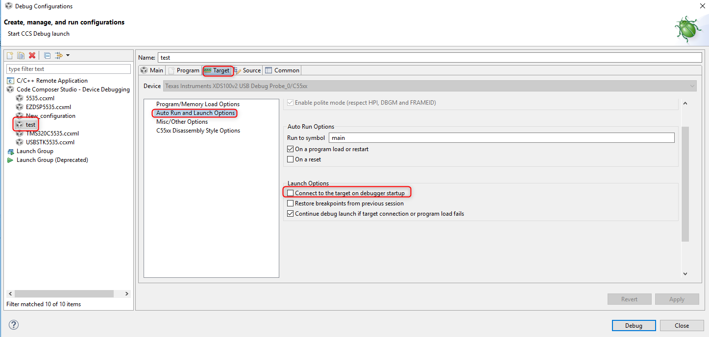

  • Yes, the demo appears to run. Eventually the debugger does stop, halted at vErrorChecks after all 4 LEDs are lit up in different colors.
    How I am running the demo:
    i am using the EZDSP5535.ccxml file in the project to start a manual debug session. I manually connect to the target and load the program.
    CCS 8.1 has an EZDSP5535 option. I created one from scratch and use that one successfully also.
    I tried the "Debug" button also. I noticed that the 'test' debug launch configuration has the option for auto-connect disabled. Is that intentional? The default for project based launch configurations is to have it enabled. If it was not intential, you may want to delete the launch config and let the debugger generate a new one.
    ki

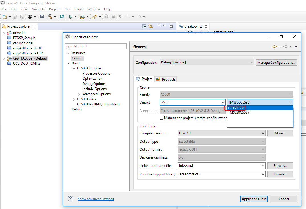

  • Ki,
    When I start v8.1 - I do not show any EZDSP5535 option - there is one for the 5505.
    Can you take a screen shot of that also and post? When I look at the project settings that does not show up for me.
    And if that does show up for you and not for me - then I'd like to know why that's happening.
    John
  • In CCSv8.1.0:
    From target configuration editor:
    In project settings:
    What are the options you see for both methods?
    ki
  • Ki,
    OK - but I believe that's using the file I supplied vs. what comes with the compiler/IDE - that's what I meant - but, let me try that real fast. Not on my dev machine at the moment but I'll be back to you in around 15 min.
    I didn't realize that would work.
    John
  • The options that appear in the board/device list is determined by if the device.board xml file exists for it in CCS. What existing ccxml file you imported into your workspace/project would not matter. If there was no CCS support for it, then those ccmxl files you imported would simply not work at all (CCS would complain that 'EZDSP5535' is unrecognized).

  • Ki,
    EZDSP5535 does not show up for me.
    So, why is happening?  Works for you, not for me.
    John
  • I can probably explain why it is happening. I will bet that the ezdsp5535.xml file is missing in your CCSv8 installation directory. It *should* be in:
    <CCSv8 INSTALL DIR>\ccsv8\ccs_base\common\targetdb\boards
    Why is it missing for you? I am going to guess that since the board is from Spectrum Digital, you need to have the Spectrum Digital drivers installed, in addition to C5000 device support installed. I'm guessing you did the latter but not the former?
