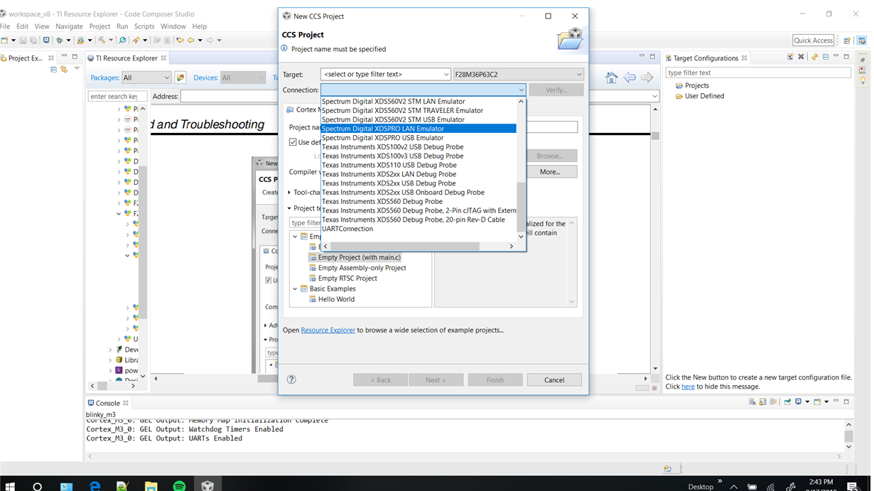

    So Im going through the F28M36x Firmware Development Package User's Guide and following the project creation section and im running into trouble when building the target.  Inside Code Composer, for the connection drop down, I cannot find the texas instruments xds100v2 usb emulator. Im not sure were I would be able to find it.
    I see it in your screenshot - it is listed as Texas Instruments XDS100v2 USB Debug Probe.
