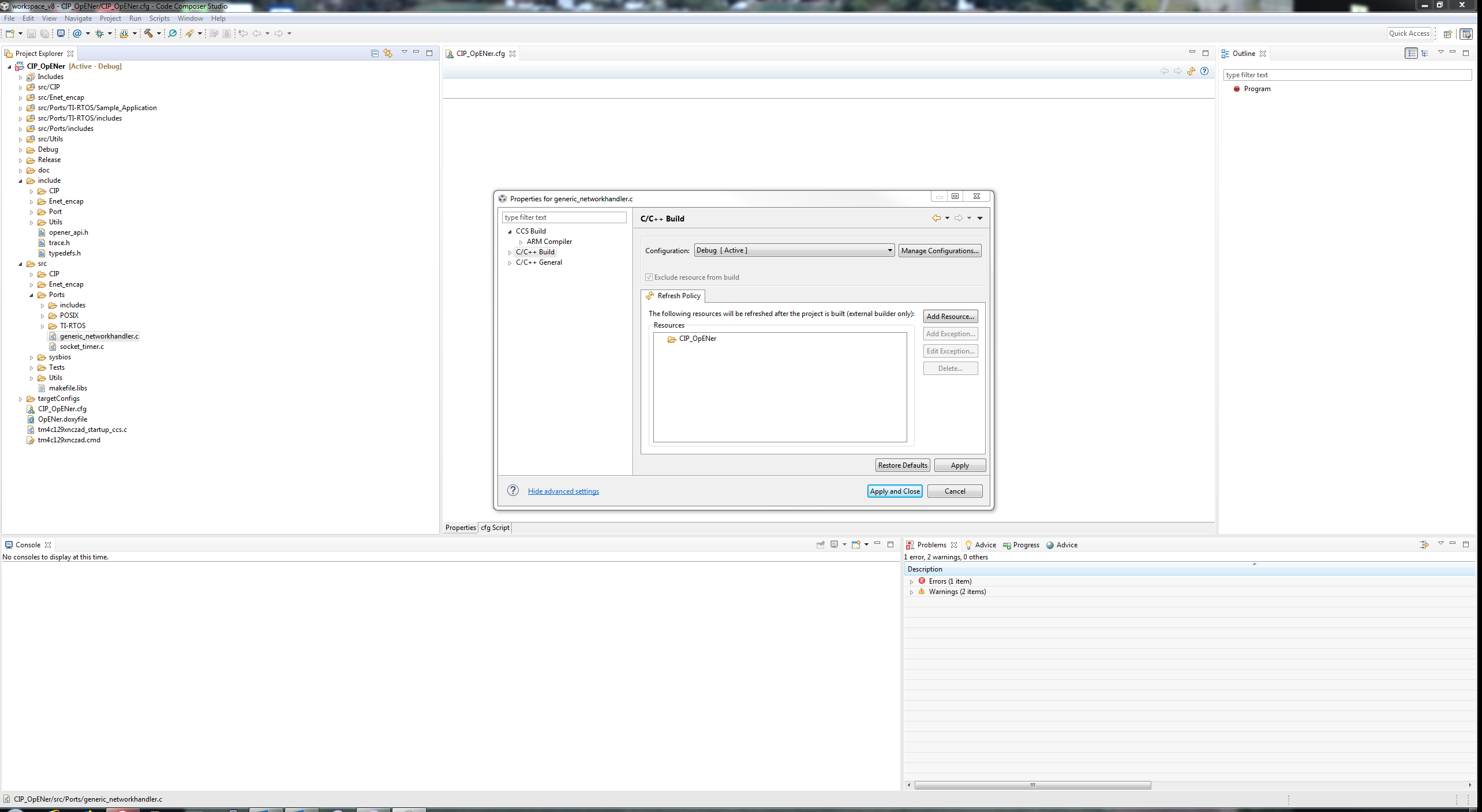

  •  Here you go-
    I can't turn of the Exclude option on these files

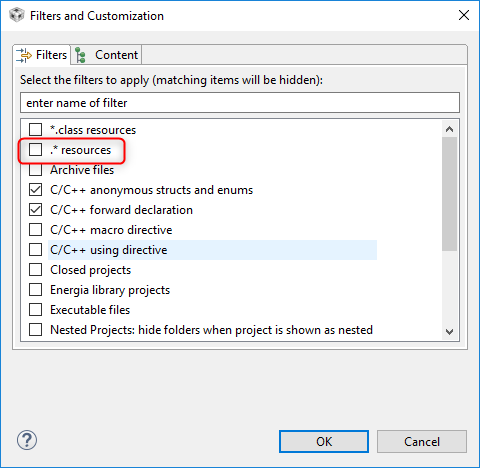

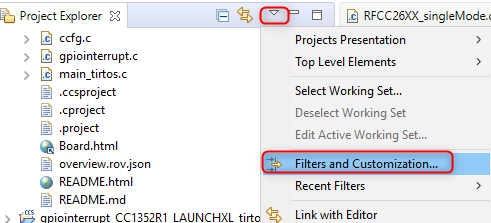

  • Can you do the following:
    Modify the Project Explorer filter to show .* files.To do this, go to the following menu item:
    Then in the dialog that appears, make sure the highlighted option is NOT enabled:

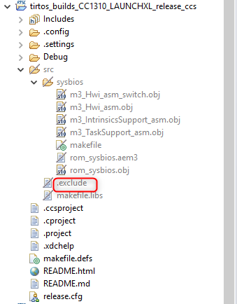

    Hit OK and then in the 'src' folder, check to see if there is a file called .exclude:

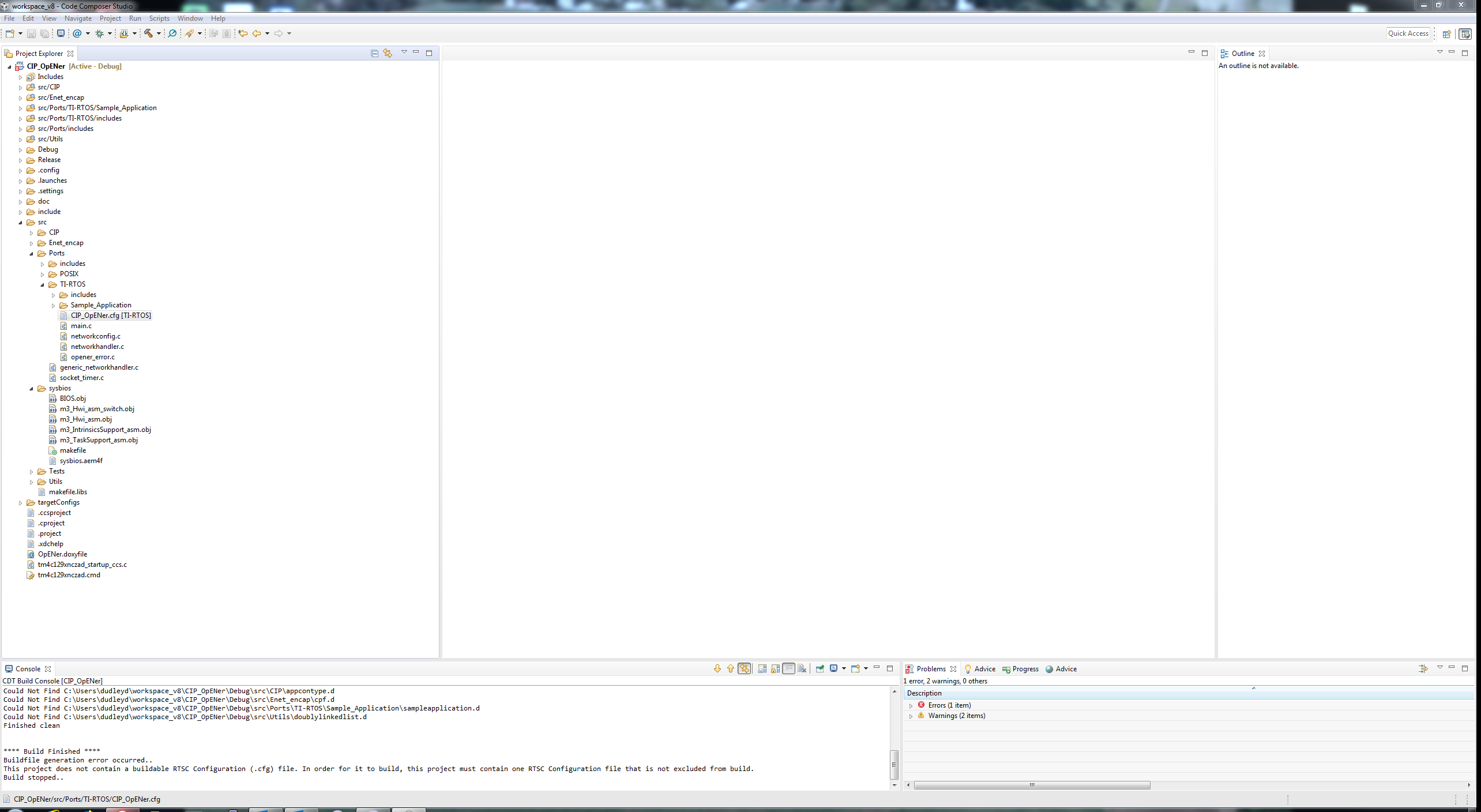

  •  Yes, there was a .exclude file there.  I deleted it, and now I get a different error.
    My .cfg file is listed as 'Exclude from build', and I can't turn that off.  I'm sure it's probably as simple a problem, but...
  • Note that your project is a TI-RTOS project. TI-RTOS projects will create an 'src' folder and place generated files in there. This folder is auto-excluded from the build via the .exclude file. This folder is excluded from the build since the contents of the folder are not meant to be part of the build. Otherwise build errors can occur. Are you placing your own source file in a 'src' subfolder also?
