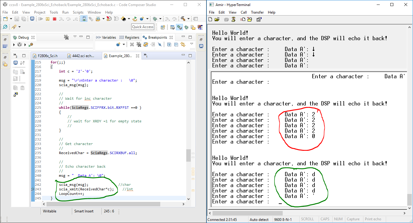

Hi.
I will send char data from arduino uno using keypad, For example, I send data 15, I want to make an arithmetic program on TI where TI receives the data and share it with 5. I hope the data that appears on PuTTY is 3 (because 15/5) .
What I want to achieve is the number or data that has been received will control the output, such as speed, angle, etc. But, first I want the data sent by Arduino to be calculated on TI and TI can display the results in PuTTY. I use Example code: sci_echoback.
I use the default program and I want to ask which one I need to change to get what I mean as above?
here my ccs code :

    So,
    Sir Barkley, i want to multiply  the data from arduino by 2. I already try. But, it didn't work. If i don't multiply it, it is going well (i input data from arduino '2222' and hyperterminal show the same data). But if i multiply the data by 2, the hyperterminal shows 'dddd'. maybe it was coming from d=100, 100 from 50*2 and i gues 50 is the decimal from 2 ascii.
    i want hyperterminal shows '4444' if i multiply '2222' by 2.
    Down below is my code that i already captured.
    Do you know something, Sir?
    Amir
  • Again, You need to convert the chars '2222' into an integer, multiply that by 2 and convert that integer into a char, sprintf() would be easiest.
    for example ('2' - '0')*1000 + ('2'-'0')*100+('2'-'0')*10+('2' - '0')
