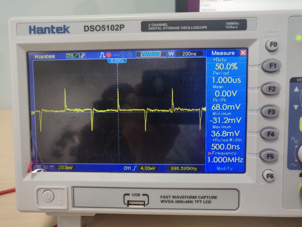

CCS/EK-TM4C123GXL: SSI Communication Issue in Master Mode receive (with Arduino)
Part Number: EK-TM4C123GXL
I am trying SSI communication with TM4C123GXL and Arduino Uno. I am using TM4C123GXL as Master and Arduino Uno as Slave and I want to read data sent by slave. But on configuring the master (SSI0) I am getting 1MHz CLK and CS pin is also working fine(Refer Picture Clock and Chip Select). While on Tx pin of Tiva Board There is some issue.(Refer Picture TX Tiva).  I want to receive data from UNO using SSI. My main goal is to interface LS7366R Encoder Buffer with TM4C123GXL which works on SPI. So can anyone help on this. I am attaching pictures of oscilloscope.

  • It looks like a drive conflict on the SSI0TX pin. Would you please check the output of this pin when it is disconnected from the rest of your circuit (just connected to the oscilloscope)?
  • Hi Aditya,
    I don't see you configure the pin PA5 for SSI0TX in GPIOPinTypeSSI(GPIO_PORTA_BASE, GPIO_PIN_4 | GPIO_PIN_3 | GPIO_PIN_2). . I only see you configure PA4, PA3, and PA2 for RX, CS and CLK. Please fix this issue first.
  • I have corrected the thing and now its working. I am now using SSI2 for this and interfacing LS7366R Encoder buffer with it. But I am not able to read the encoder count. Please check and help.

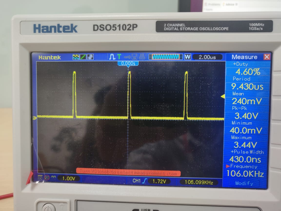

  • Remember that every time you do an SSIDataPut(), something is read into the SSI receive FIFO. It may be garbage information. You should do an SSIDataGet() for every SSIDataPut() you use when configuring the encoder, or do multiple SSIDataGet() to empty the FIFO before you do the SSIDataPut() of dummy data used to read the encoder.
    This is also not working.
  • You need to provide more information than that it is not working. I suggest you use the oscilloscope or better yet, a logic analyzer and compare the signals at the SSI with what you expect. Remember that since the Encoder chip is not from Texas Instruments I cannot help you understand that part.
  • My issue is now resolved as I have took care of everything regarding FIFO buffer. Thank you all for your advice. Now I am able to read data from LS7366R quadrature encoder buffer breakout board. I can now access the encoder values easily. Here is the code.
