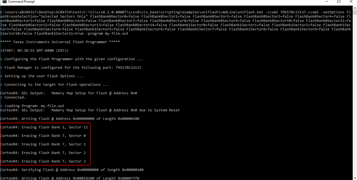

  • Additional data: In Code Composer Run | Debug Configurations | Target Flash Settings, I checked "Selected Sectors Only" and checked Bank 1, Sector 11 as well as all the sectors in Bank 7. This must have somehow tricked the flash loader because now Bank 7 programs OK. See console output below. This would be an acceptable solution, however, I'd also like to be able to do this from Uniflash but don't know the command line syntax.

  • Try:
    >C:\ti\ccsv8\ccs_base\scripting\examples\uniflash\cmdLine\uniflash.bat -ccxml TMS570LS3137.ccxml -setOptions FlashEraseSelection="Selected Sectors Only" FlashBank0Sector0=false FlashBank0Sector1=false FlashBank0Sector2=false FlashBank0Sector3=false FlashBank0Sector4=false FlashBank0Sector5=false FlashBank0Sector6=false FlashBank0Sector7=false FlashBank0Sector8=false FlashBank0Sector9=false FlashBank0Sector10=false FlashBank0Sector11=false FlashBank0Sector12=false FlashBank0Sector13=false FlashBank0Sector14=false FlashBank1Sector0=false FlashBank1Sector1=false FlashBank1Sector2=false FlashBank1Sector3=false FlashBank1Sector4=false FlashBank1Sector5=false FlashBank1Sector6=false FlashBank1Sector7=false FlashBank1Sector8=false FlashBank1Sector9=false FlashBank1Sector10=false FlashBank1Sector11=true -program my-file.out
    ki
  • I tried ki's suggestion. Uniflash didn't complain about this rather lengthy command line but did ignore the "Selected Sectors Only"  directive and erased all flash sectors.
  • What does it say in the console output regarding the erased flash sectors? for me, I see:
    ki
  • OK, I found a typo in my command file. I fixed it and now I do get the same results as those reported by ki above. This solution works for me! Thanks ki.
