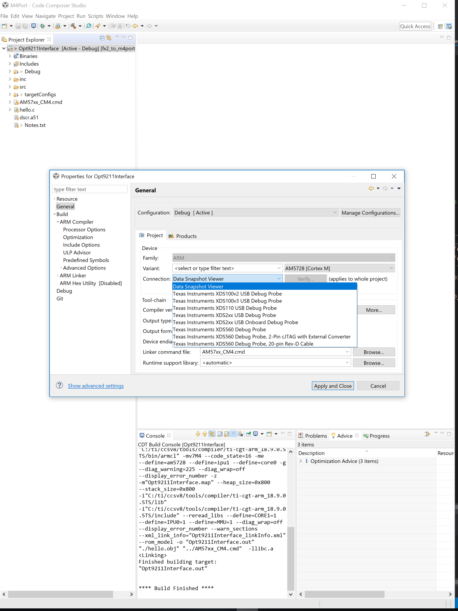

I have un-installed and reinstalled the Segger for Windows plug in. The connection option is still not available. Any suggestions on how to proceed besides uninstalled and reinstalling? I have used the Jlink for other devices with the current USB drivers, so I highly doubt that is the issue.

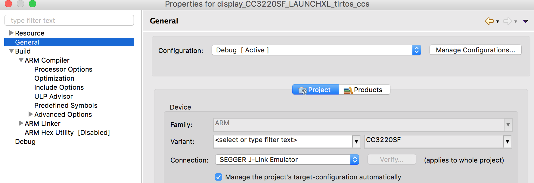

    The screen capture are not coming through.  Are you attempting to use CC3220SF like in the other thread or a different device?

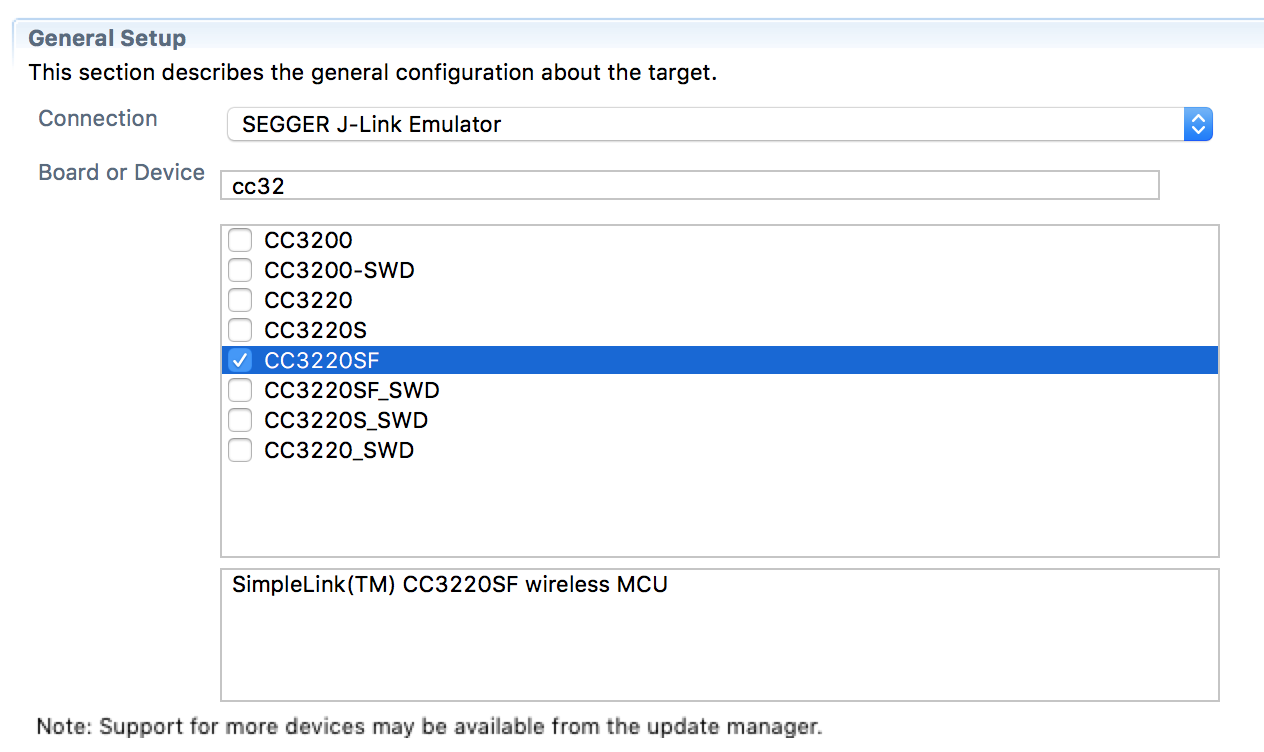

    For me CC3220SF is showing up as valid for JLink
    Here I can create a new target configuration that has J-Link and CC3220SF:
    If I import an example from the CC32xx SDK I am able to change the debug connection to J-Link:

    Thanks for the note on the screencaps. Looked like it was fine before I posted, but I guess it got lost in translation.
    Specifically I am attempting to target the AM5728 (dev board from Phytec), but the J-Link is not appearing for this device. It's not that I am unable to verify the JTAG electrical connection, it just appears to not exist for this device.

  • The cores I want to target are the M4 cores for IPU1 (non codec processing IPU core). The whole rationale here is I need to be able develop towards these M4's, and I haven't found a means of remotely deploying the code onto the sitara, building, and then reprogramming the IPU from that environment so far. If there is a means of performing it that way, I can re-use my existing work-flows I have setup for the application code.
    Since it is a generic M4, I wonder if there is a different process to get this configured correctly or built properly. Either way, I will send in the request to Segger to get it added.
    The A15s I am using generic G++ over SSH to debug and control, so that isn't something I entirely need.
