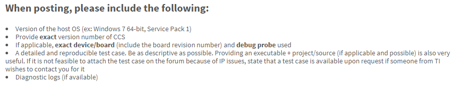

  • Hello Freddy,
    could you be a more specific before someone from TI will reply?
